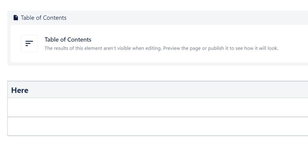

Bit of a hard one to show via screenshot but basically when using the table options and have the "header row" ticked the table of contents macro will recognise it as something to be included, but the link part of it will not work. If you then untick the "header row" option the link part then works.
Have attached a screenshot but again not sure if it provides any help.
@Dan Billingham your screenshot certainly did help! I was able to replicate this in my test instance. And lo and behold, I experienced the same behavior you have seen.
