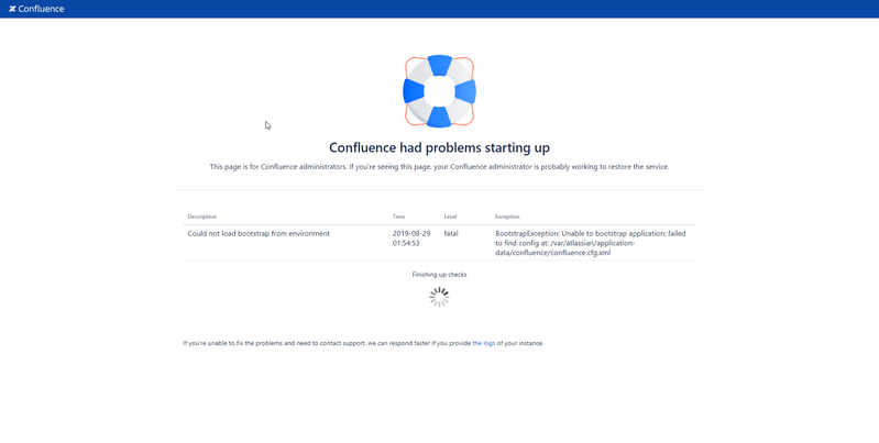

Shortly after running the startup cmd the cpu usage and ram growth will level off and navigating to the confluence instance will show this " Could not load bootstrap from environment " error.
When I google that error I find some docs saying it might be a corrupt config file but seeing as it remains untouched in a persistent volume during upgrading and still works if I revert back to 6.15.7. I expect that is not actually the issue here.

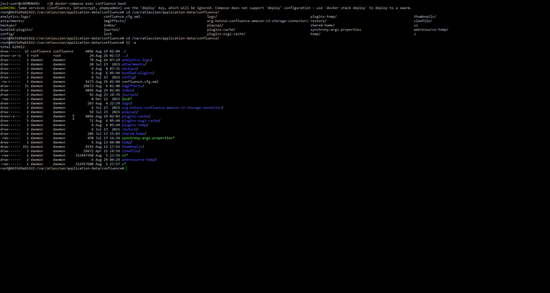

If I navigate around the confluence docker containers filesystem I can see that application-data is still mounted and what looks to be the permissions I would expect.

Pretty sure I figured it out, ended up being a premissing error.
A change made earlier this month switched from running the confluence appdata dir under the built in deamon user, to creating a new confluence user with uid:gid of 2002:2002 during startup and running under that. Also I'm pretty sure the confluence docker image used to always run a chown on the /var/atlassian/application-data/confluence/ dir during startup to prevent issues like this but I guess that isn't working or has been removed.
