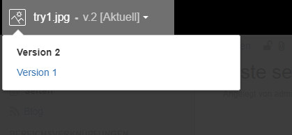

I've found out, if I view the file with click on it (Pictureviewer in confluence):
I could have a look at version 1 (the right one!).
But if I go to the attachments site, I can't see the right version of "version1", there I only get version 2 (although there are 2 different files)

If I click on the picture to open up the pictureviewer and do rightclick in my browser on it -> open in another tab (to get the full link of the picture) it shows me this one:
Version1:
http://...:8090/download/attachments/327693/try1.jpg?version=1&modificationDate=1509269853500&api=v2
Version 2:
http://...:8090/download/attachments/327693/try1.jpg?version=2&modificationDate=1509269909261&api=v2
But if I go over the attachments site, and open the picture here, I've got following link:
Version1:
Version 2:
The different here I've marked in bold (way over pictureviewer, there isn't any "amp;" in the link, but at the attachments site, there is?!)
Next very curious behavior is:
If I open like the way over attachments site and edit the link manual (remove the "amp;" that I've get the link like way over picture viewer) and load it, I've got the right version!
BUT: If i edit manual the link, remove the "amp;", load the site, and want to have a look way over the picture viewer like this:
I cant get the right one of "Version 1". After this manual edit of the link, you can't get Version 1 without accessing the file system and search for it...
I think there is maybe a problem with the api?
I hope this helps a little bit to find any solutions for this problem.
Many thanks in advance!!
