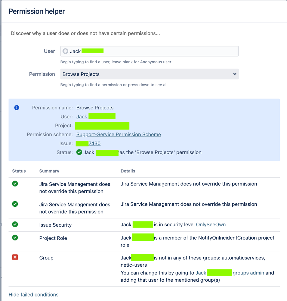

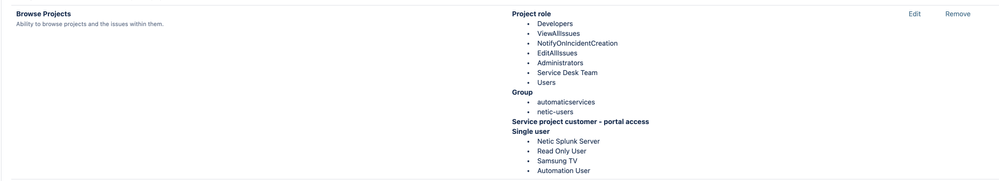

Hi Stefan
This is part of the "Support-Service Permission Scheme":
The reporter is not a part of the "Browse Project" - but this is the status:
just noticed the "NotifyOnIncidentCreation project role" - DOH !
