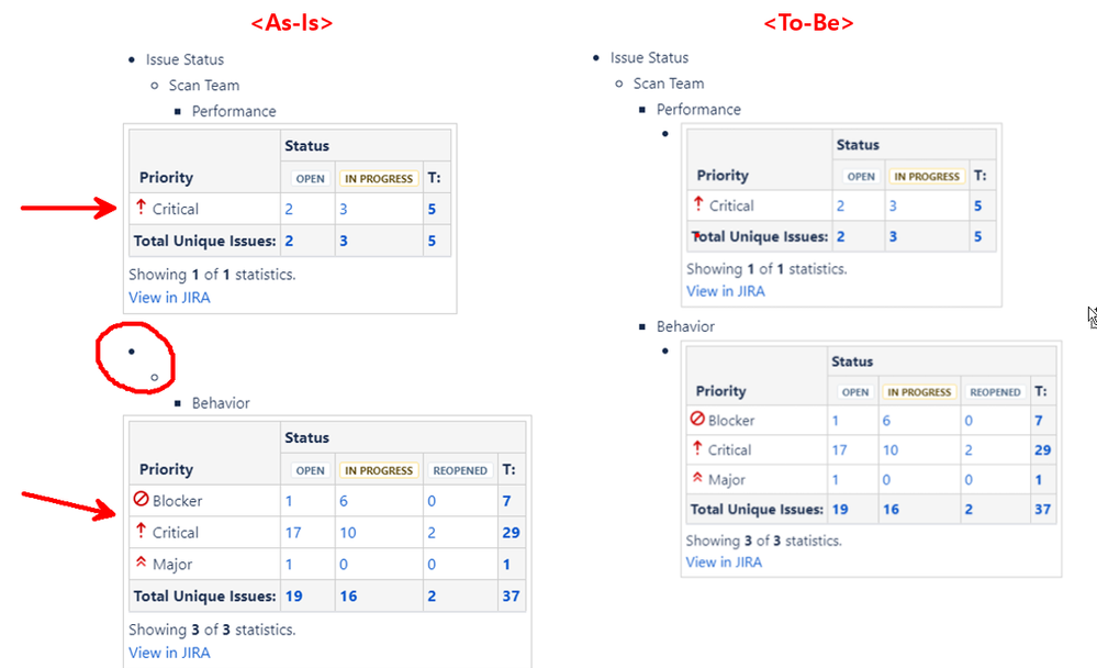

We are quite often using JIRA Chart in Confluence page.
Please see the attachment. the left side is As-Is having problems and the right side is To-Be I want to make.
As you can see from the image on As-Is left side, I cannot apply the bullet points to the JIRA Chart. so, It is also impossible to make an indentation for it. therefore, I should make some unnecessary bullet points for making the next row alignment.
How can I make the Confluence page like the left side, To-Be.
For reference, I make the Left side by making the Table to picture image. but, I don't want this way because the table should have a link and be kept updated.

Hello @Jiebyoung Park!
As I understand, you need to insert the Jira Chart macro in a list.
Currently, adding macros inside bulleted or numbered lists is not something the new editor does. This is being tracked here:
As expressed in the report itself, you should still be able to use the Legacy Editor, where this feature is available:
I do encourage you to go over to the report (CONFCLOUD-67862) there and share your current experience with this situation.
