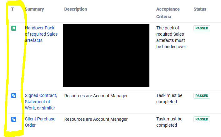

When using the Jira Issues macro in Confluence, the value returned for the issue Type field isn't text, it's the icon for that issue type:
Is there a way to return the text value of the Issue Type, like 'Story', 'Epic', 'Risk' etc?
When exporting the table to a CSV, the Type column is always empty. Also, when using third party charting or filtering macros, the icon has no meaning to be used for text filtering or charting.

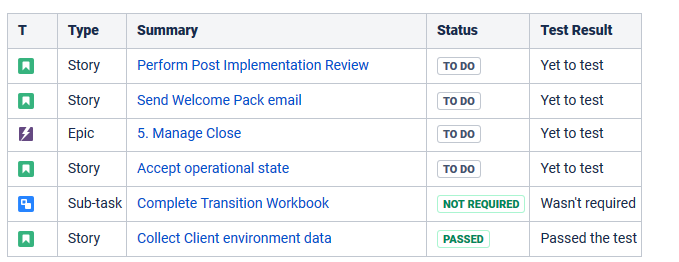

Here is an example of a resulting table:
Presto! The issue types as text.
