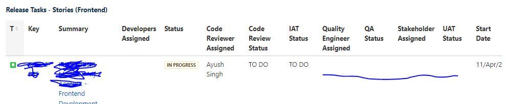

We are not able to fetch some of the Custom Field Value through Jira Macro Filter report in confluence for almost a month, its not new custom fields, they were actually pulling fine, all of a sudden since a month, its not fetching correctly.

Field Types - Dropdown, People
Issues from a Team Managed Project. Also i tried Refreshing many time using Refresh icon, still the data is not fetching.

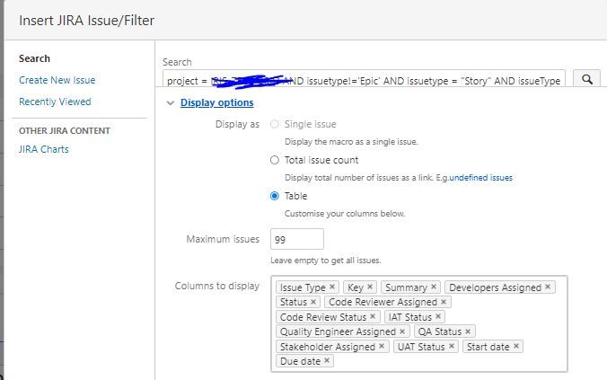

Can you show the configuration dialog for the macro?
I am able to show both types of fields in Confluence Cloud using the basic Jira filter results macro.
