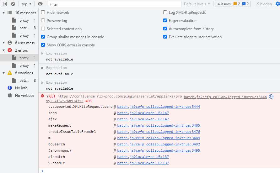

In debug window I only get the following
