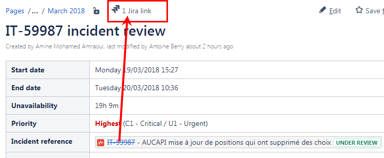

Since Jira (to 7.8.0) and Confluence (to 6.8.0) upgrades this week, having a Jira issue reference in a confluence page does not link the issue and the page together anymore. Issues linked before the upgrades still display a link on both the page and the issue.
The application links are correctly set.
I do not know which upgrade caused this since we upgraded on two consecutive days.
Thanks for your help.

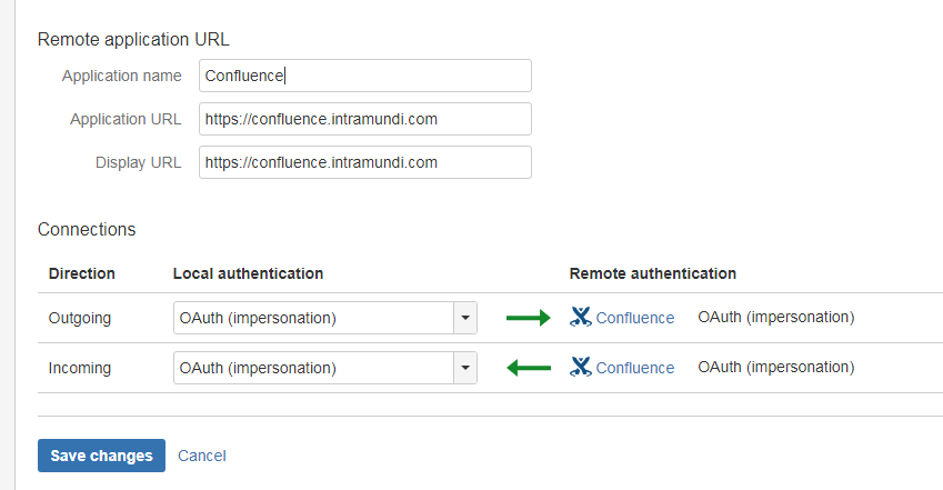

I realize you mentioned your application links are set up properly but I am not sure whether you are using OAuth with impersonation. Please try OAuth with impersonation for your application links and see if the Jira issue links appear as expected. Please review: OAuth security for application links for details on the functionality of the different OAuth methods.
Hi Ann, I think the connection is correctly setup. See attachments.

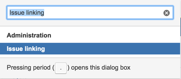

I just tested with Confluence 6.8 and Jira 7.8. I found that the links from Jira to Confluence did not get created if I deactivated issue linking in Jira under Jira Administration>Issues>Issue linking. Another way to get to the configuration is to type a period "." and then Issue linking:
Please make sure this feature is activated in your Jira instance. If it is not, please activate it and test the Confluence links again.
Ann
Hi Ann, Thanks for your answer. The Issue linking feature is indeed activated.
