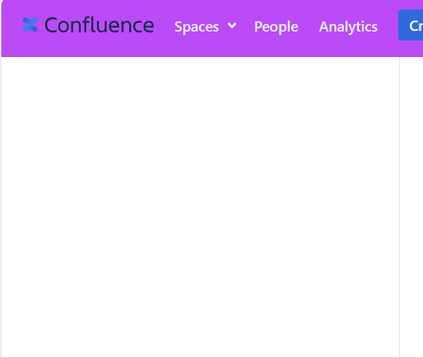

On all of the Spaces I have on my Test-server the Sidebars are empty after upgrading.
Not even the Cogwheel and the Space Tools menu is there.
If I go into Space Directory and select the (i) for any space, the Sidebar renders but without any shortcuts or Page Tree

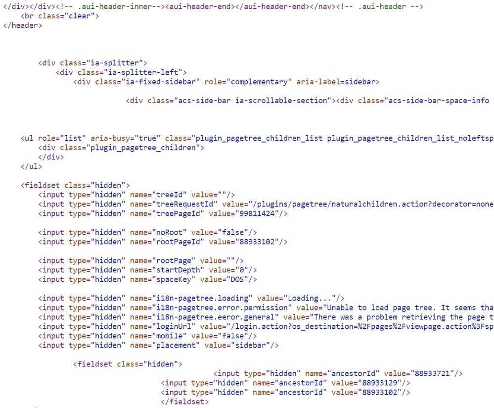

The entire sidebar is missing from the HTML. Including the hidden parts about not being able to access the sidebar:
In 9.0.1
Versus 8.9.1

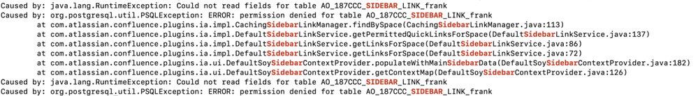

I also had the same issue. Log said DB permission issue:
I worked with DB team and fix the permission issue.
