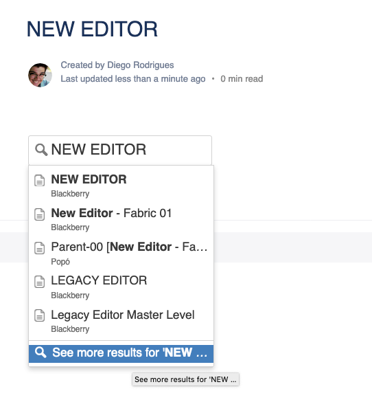

I tested out on my Confluence site and it seems to be working as expected:
However, if I type my search and then press enter the results are exactly as you described. This happens because the Enter/Return key corresponds to clicking the “See more results for” option, right after all the search results are displayed.
