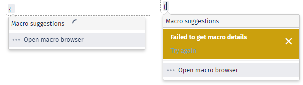

thanks for your help. In my experience, it only happens after a confluence restart. Today I was able to take some screenshots and get the logs. Using the front end I got the following result:
Left: initial - times out after maybe 60 seconds
Right: Time out - on second retry opened up the macro browser as expected.
