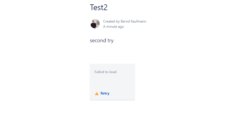

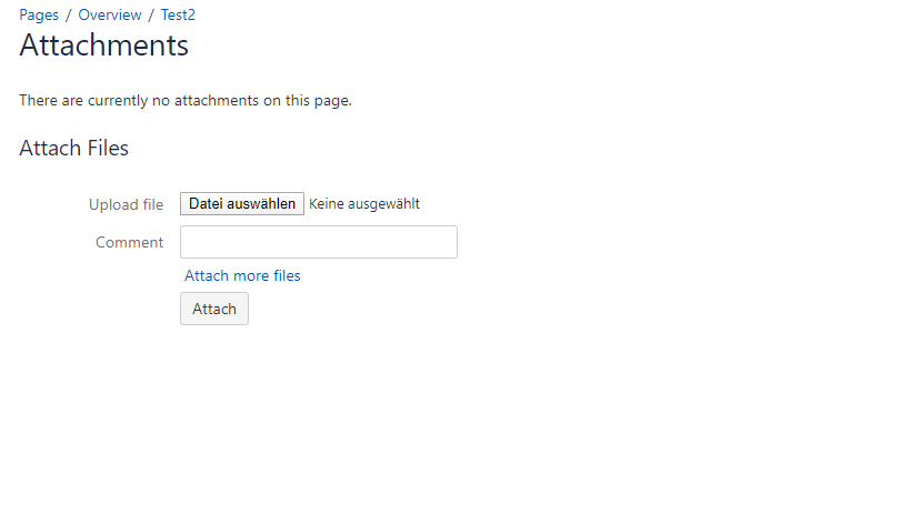

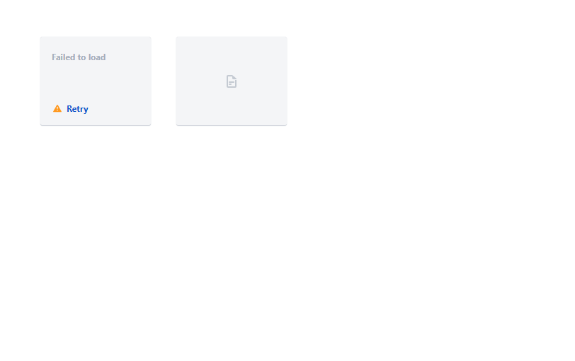

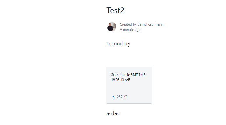

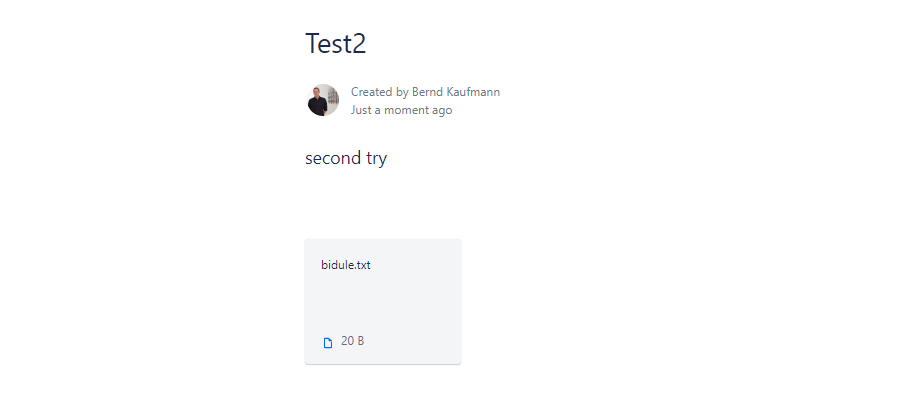

Sceenshots:
After step 3:
after step 5:
after step 6:
after step 9:
