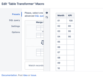

Hi all,
im struggling to create a merge 2 tables where 1 of them is a result of a table transformer macro with the goal of getting automatic updates and avoid any manual intervention. See below the case:
1. Fixed table
2. Macro table ("KPI" data)
I've tried adding both tables to a new table transformer macro where do the merge (using default SQL config), this is the actual result:
Desired result
where "100" is somehow automatically fetched from the table transformer macro. Each month will have a specific table transformer result so the "Response Times" column name should be changed to "01", "02", ... to do the proper mapping, just did it this way for example purposes.
I assume it's about SQL code to the the proper join and columns mapping, but were not able to find a workable solution for this so far.
Thanks in advance for your attention and help!
Esteban

So to add the KPI you need to generate one big or several small tables with the format:
|Month |KPI |
|02        |100|
Then the result will be as following:
|Month |Col 2             |KPI |
|01        |Some info 01|      |
|02        |Some info 02|100|
|03        |Some info 02|      |
|04        |Some info 02|      |
Hope I was able to clarify the case a little bit for you.

It seems that the case is more simple - don't change anything in the SQL query and just choose the Look Up preset.
Here is my example with one stable table (and it doesn't require the KPI column, the Month column is enough) and three mini-tables (let's pretend that they are generated by other internal Table Transformers):
Then I choose the Look Up preset and the common Month column is shown for me to choose by default:
And here is the result:

It worked like a charm:
And as for my final goal as well:
So all working as desired and no manual work other than initial config.
You rock @Katerina Kovriga _Stiltsoft_ :)
