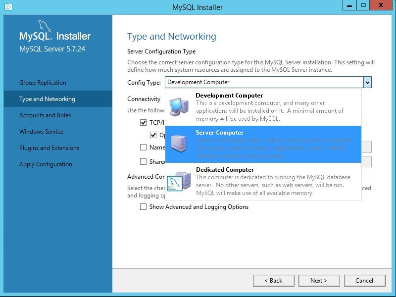

You should be good to go by setting the MySQL application as Server Computer and as Windows service as well. It should prevent the Confluence server form coming up without a database. It is a good idea to start the database before starting Confluence.

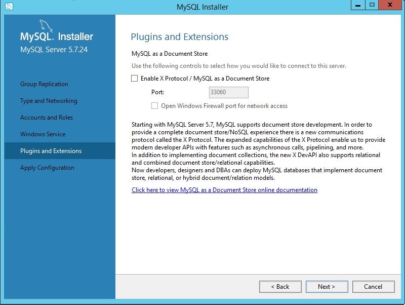

Also, there is no need to activate the plugins shown with the installer. After finishing the setup, you can end the MySQL process and apply the necessary changes to your my.ini file, as shown here:

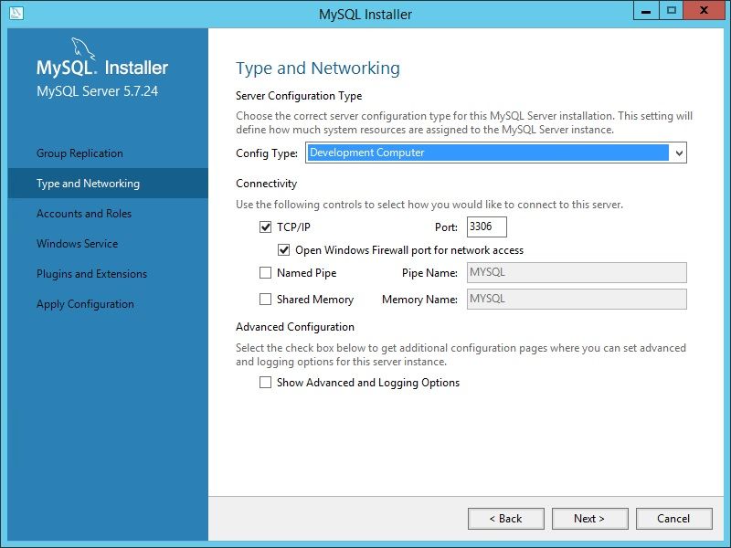

 If I choose StandAlone MySQL / Classic MySQL Replication I have the following options:
If I choose this option, I need to choose a config type. This would be Server I believe. Click Next.

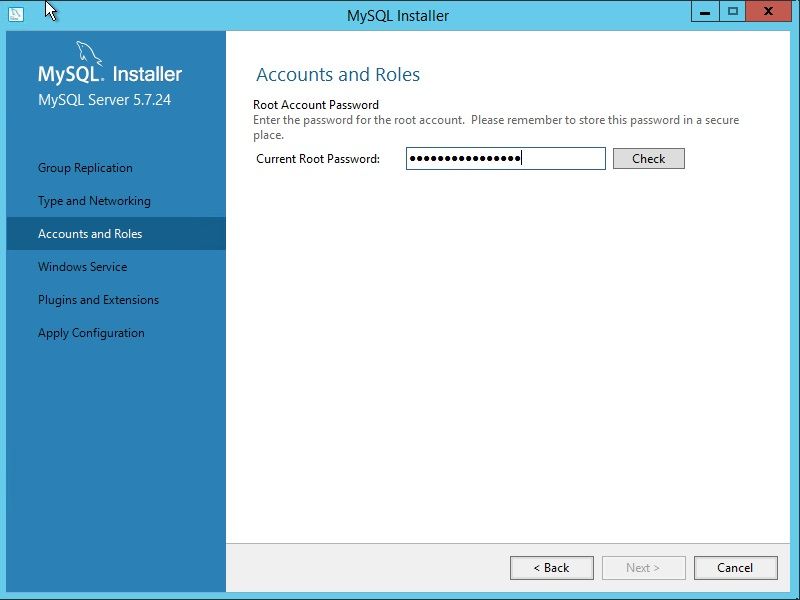

I enter the root password on the next screen. Click Check and then next.

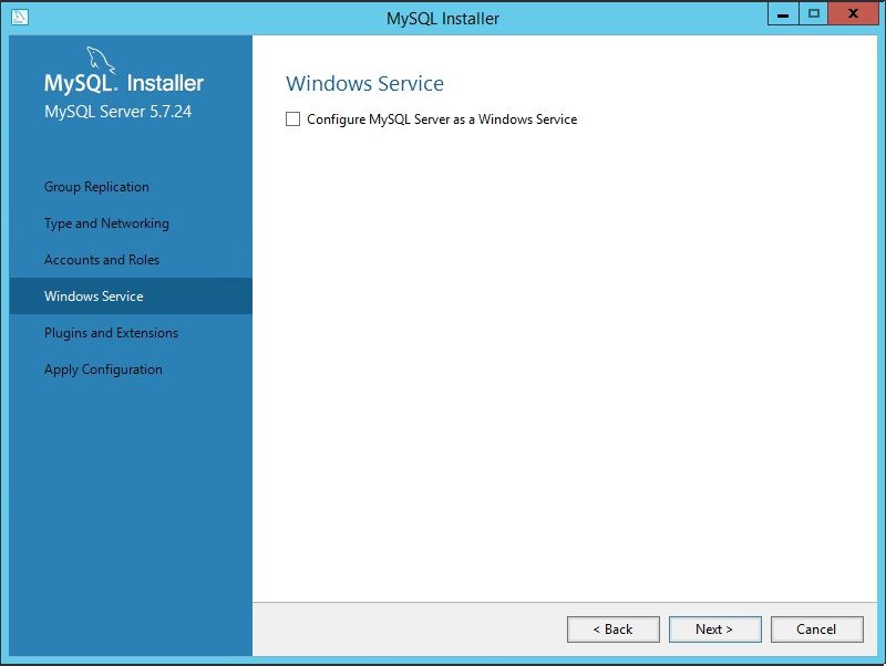

In the Windows Service window I'm given the option to configure mysql to run as a service. I leave the default and lick next.
On the Plugins and extensions screen, do I leave the default and click Next?

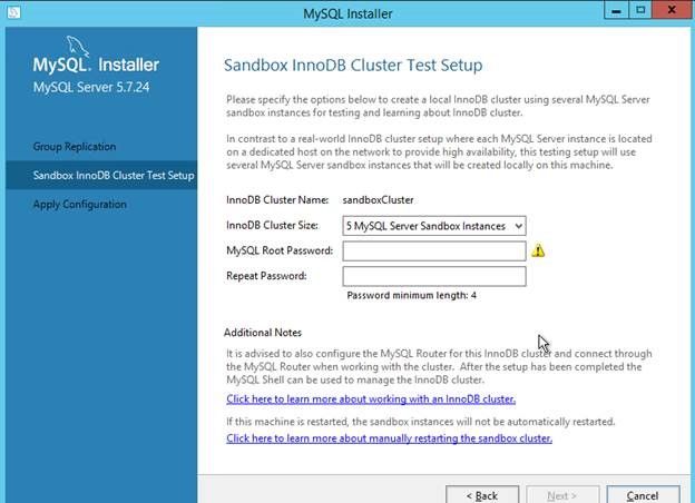

If I choose the Sandbox InnoDB Cluster Setup (for testing only) route from the main setup screen, I get these options:
What Cluster size do I use? Plus it specifically states “TEST”, which we’re not running. This is production.

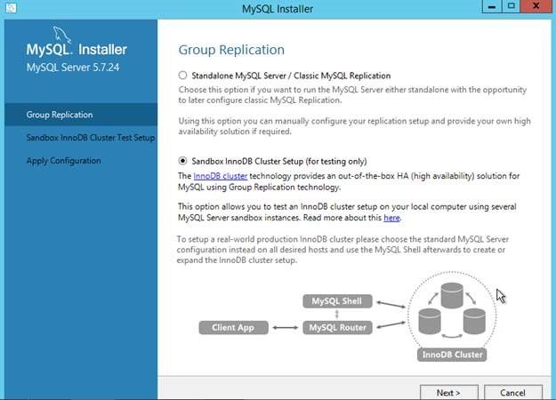

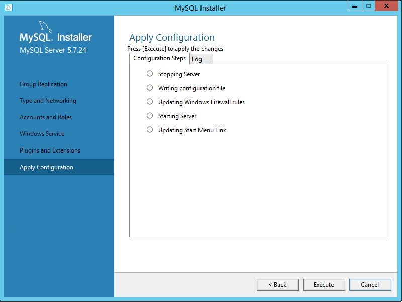

The screen that follows is simply to execute the setup.
In the Windows Server window I'm given the option to configure mysql to run as a service. I leave the default and lick next.
In the Windows Service window I'm given the option to configure mysql to run as a service. I leave the default and click next.
Thanks for your help. Please provide me some updated docs/steps asap.
