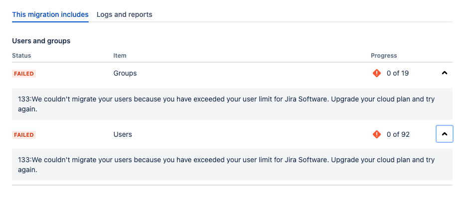

We have 50 active users on our Jira server and 42 inactive users. Our license on the cloud is also for 50 active users. When I try to run the migration I receive the error :
“133:We couldn't migrate your users because you have exceeded your user limit for Jira Software. Upgrade your cloud plan and try again.”
I am not seeing any way to just migrate active users or migrate all users with same status as they have on our Jira server, meaning the inactive stay inactive on cloud and don’t count towards our license limit of 50.
Can you please let me know how to proceed ? Is there a way I can run the migration currently or do I need to delete all inactive users from our Jira server and then run the migration ?

Hi @Ash Yadav ,
Thank you for your message. Yes we have 50 active and 42 inactive on our jira server but on the migration tool it is showing the total meaning 92 users to migrate.
I am guessing that it is trying to migrate all 92 as active users and that is causing the issue ! We have same license, meaning 50 active users on the cloud.
Any idea how I can run the migration in this case ? Ideally I don't want to delete the inactive users from jira server.

Hi @Ash Yadav
Forgot to update but the issue was fixed by atlassian support by removing the limit on our cloud site for the migration to complete ! Seems to be working fine now.
