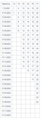

Stephan Schmitz February 10, 2023
Dear @Katerina Rudkovskaya _Stiltsoft_ ,
thank you very much for the time spent on my problem, I really do appreciate it. Your tip helped me to get further. It dawned to me that I must somehow modify my requirements and came up with the following.
I changed the months into a date (x-axis) and the project timing I started to count in months (y-axis). Now I can see how different milestones are progressing over time.
However I am not able to modify the x-axis into month year scaling, it stays with date month year...but I can live with that.
thanks for your help
Stephan
February 10, 2023
You can change the date format in the Reporting column of your source table to have it in the x-axis of the chart then. It's possible to do with the help of Table Transformer.
