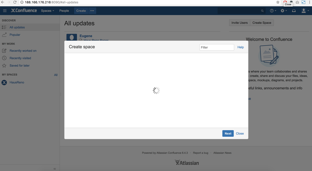

even i clicked on the ... button it shows the infinity loading
i have also checked in console.
http://188.166.176.216:8090/rest/create-dialog/1.0/blueprints/web-items?spaceKey=HAUS
it shows this error 500
{"errorCode":500,"errorType":"UNKNOWN","errorMessage":"bundle [com.atlassian.confluence.plugins.confluence-create-content-plugin]"}
what should i do next?
please advise
please advise
Since you are using MySQL I would like to ask you to check whether MySQL server is configured to have NO_AUTO_VALUE_ON_ZERO mode enabled as described in: Create Space Dialog Loads Indefinitely
yes i have set that in
vim /etc/mysql/mysql.conf.d/mysqld.cnf
sql_mode = NO_AUTO_CREATE_USER
i coundnt find it in there so i just add another line to it
I can confirm that removing NO_AUTO_VALUE_ON_ZERO from sql_mode fixes the create space dialog for me under MYSQL
I have just set:
sql_mode=''

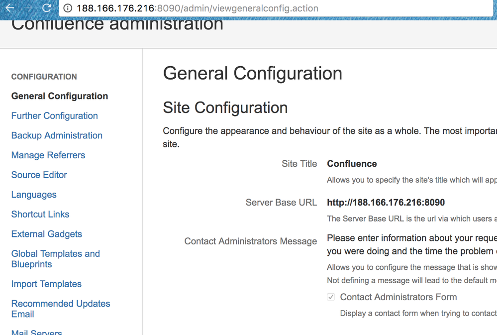

One reason for this is that If the base URL and the URL you are using to access Confluence is different you will face this issue.
it also should be working because im using the same url
please check attached document
also if theres problem i would not be able to call this link alreday
