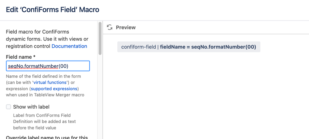

You can use formatNumber function by setting the ConfiForms Field macro's field name parameter to seqNo.formatNumber(00) when rendering the value of a seqNo field

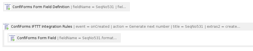

I feel like this is the right way, but I am having trouble getting it to work. Here is the layout of my current setup (only difference is "531" is added to the SeqNo) along with the views of the 3 macros in order.
The first standout is that I don't have a macro that only gives me "Confiforms Field Macro"
Currently, when I get the email, it is still showing single digit numbers with no leading "0" for those single digits (though the email has "[entry.SeqNo531]" with nothing added.

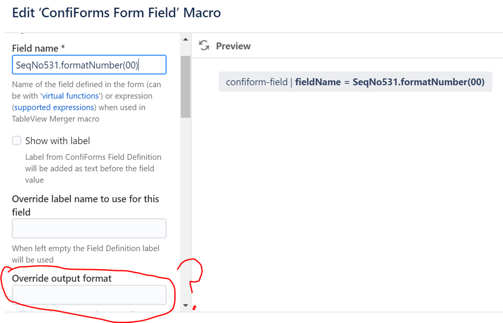

I am wondering if I should be putting this in the highlighted section for "Override output format" or if I am just setting it up incorrectly. Thank you!

Not sure why you use [entry.field_name] notations and not ConfiForms Field macros, but… the functions can of course be used there as well
so just put [entry.SeqNo531.formatNumber(00)]

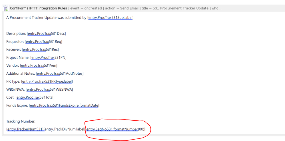

I added that line in the email output and now when the email comes in, the sequence number is blank.
Here is a look at the body of the email with the circled part being the main piece of interest. Basically, it does a Julien Calendar number, adds a selection, then creates a tracking number that resets each day. So far it works minus the double digit part, however, if I try to use the format line, the email blanks out the SeqNo531 part. Sorry if I am doing something dumb, just trying to figure out why it is so close but not cooperating.

I can only think of the garbage added by the editor - are you sure the expression is clean  [entry.SeqNo531.formatNumber(00)]
Could you verify the storage format for this piece of contents?

You were correct (as usual). I re-pasted the line into that space and now it is showing up correctly. It was definitely some garbage interference from the editor. Thank you so much, everything is working like a charm. To your bosses - give this man a raise!
