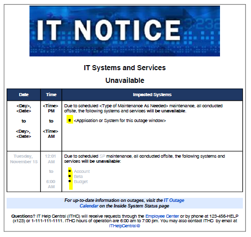

Hello Atlassian Community,
I am working on converting a Word template (we normally save as a PDF file once it is completed) over to Confluence.
I've set up the PDF Export Stylesheet with the correct formatting, but am having an issue with one item.
Currently I have a table within a Panel. This table has bullets. I've been able to change the format of the bullet from a circle to a square but have been unable to change the color of said bullet. See screen shot below:
My write-up is as follows...
.wiki-content ul
list-style-type: square;
list-style-color: #1F3864;
font-family: ConfluenceInstalledFont, Helvetic, Arial, sans-serif;
font-size: 10px;
word-wrap: normal;
Has anyone run into this issue before and have a solution?
Any help is appreciated.--Lara

Hi there @Chu Dam I have tried just
color: #1F3864;
as well and am at my wits end! Not sure if it has something to do with it being a table inside a panel? I've gotten everything else to work perfectly...
I just tried adding the 'li::before' as you suggested but that turned my square bullets back to circles.
Thanks for the suggestion though! It looks like it is one or the other. I can either change the color and keep it round or change the style type, but not both.
I tried adding this:
ul {
list-style: none; /* Remove default bullets */
ul li::before {
content: "\2022"; /* Add content: \2022 is the CSS Code/unicode for a bullet */
color: red; /* Change the color */
font-weight: bold; /* If you want it to be bold */
display: inline-block; /* Needed to add space between the bullet and the text */
width: 1.09em; /* Also needed for space (tweak if needed) */
margin-left: -1.09em; /* Also needed for space (tweak if needed) */
font-family: ConfluenceInstalledFont, Helvetica, Arial, sans-serif;
font-size: 12px;
word-wrap: normal;
.wiki-content ul {
font-size: 10px;
word-wrap: normal;
}and it gives me a black square with a round red bullet hovering over top of it.
If I take away the .wiki-content ul, then I just get a round red bullet...the list style type will not carry over to square.
