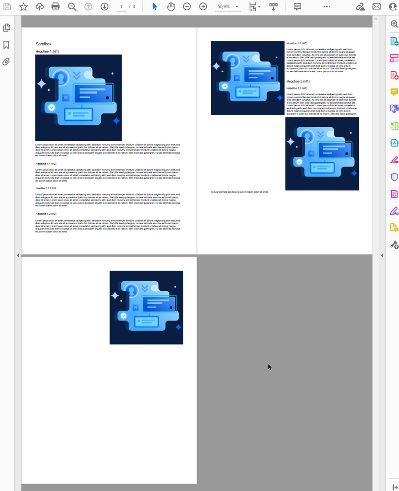

PDF-Export: The page style is awful. Headlines are exported like normal text (same size). The headline structure is for the trash in the export.
Impossible to read a well structured text.

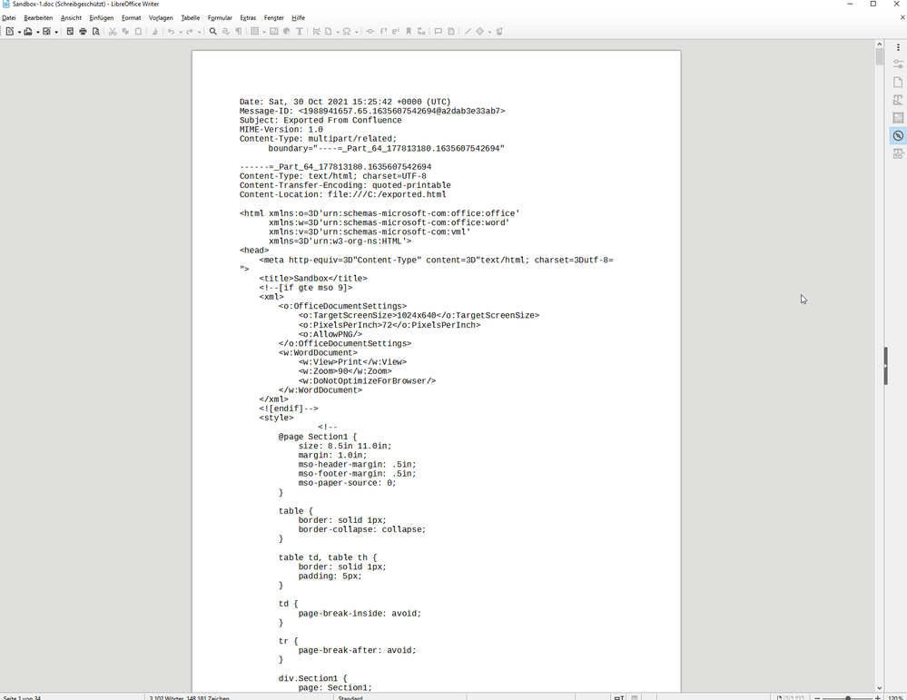

The Word export is broken to. Cannot read the content. When I open it I see the technical content (XML).

When I want to save this ".doc" file, then LibreOffice wants to safe it as txt file.
Exported as Word file opened with LibreOffice 7.1 on Windows 10

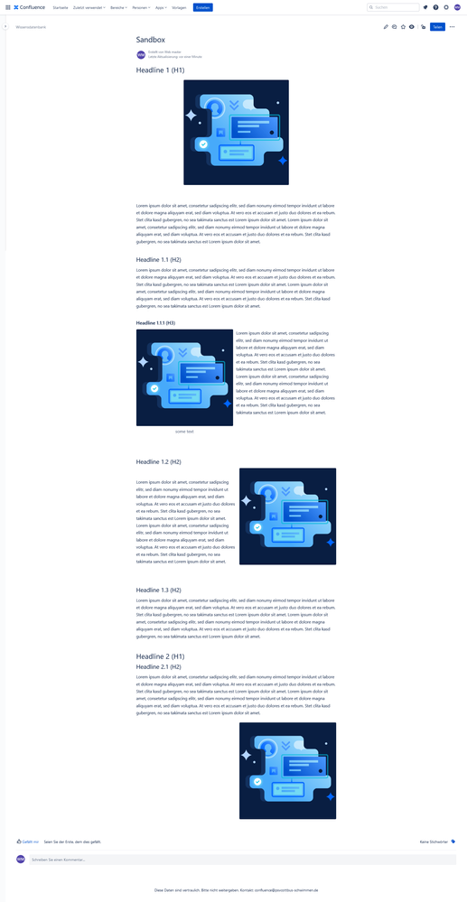

I created a test case for you:
The simple text with some simple images in Confluence
Exported as PDF (see where the images are shifted and see the little headlines)

It looks like the doc is interpreted as a regular text file despite the file extension, neither Google Docs nor OpenOffice/LibreOffice are able to read it (no problem with documents exported from other platforms). It looks like an email header with mime details and then followed by HTML XML data.
