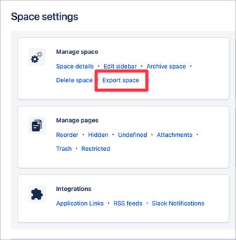

The thing that might be confusing is the fact that you need to select Export space to PDF and not going to the page you want exported and then click export to either Word or PDF. At the top of the customization you'll see that button (see attached image below). At the second screen select Custom and select the pages you want exported.

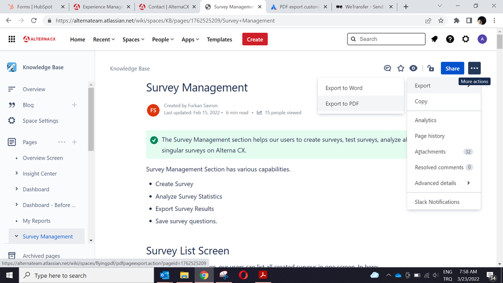

Then I tried to export pdf for any content in my spaces for example:
but nothing happens I can't see any customized item.

Second, you edited the Global PDF layout, but you mentioned it doesn't work when you try to export individual page content. Note that the Global PDF layout applies to full site exports.
PDF customization only applies to space exports (not single page exports via Tools > Export to PDF)
