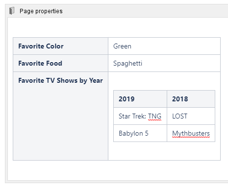

The page properties macro is meant to only have a two column or two row table. One row/column is the properties (must be a header column/row), the other row/column is values. So, really you can only have key/value pairs. Now, there is nothing stopping you from putting a tables into one of the values like this ....
You could also use the expand macro inside the value side of a property. I've done that. However, I have also found issues where the expand only works on the first page of the report.
o_loktionov November 5, 2019
I found out, it is not possible to put a table inside a cell of a table covered with "Page properties" macro.
As it is shown on the screenshot, mentioned in this question above:
Is there a way which makes possible to make work nested tables using Confluence Cloud?
