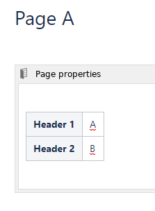

Hi @gk_b
As you already said correctly, you need the page properties macro.
All your informations should be in a table in "PAGE A". And this page needs a label.

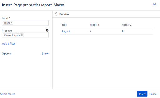

On the overview page, you need to use the page properties report macro
And you have to specify the label from "PAGE A":
Regards, Dominic
