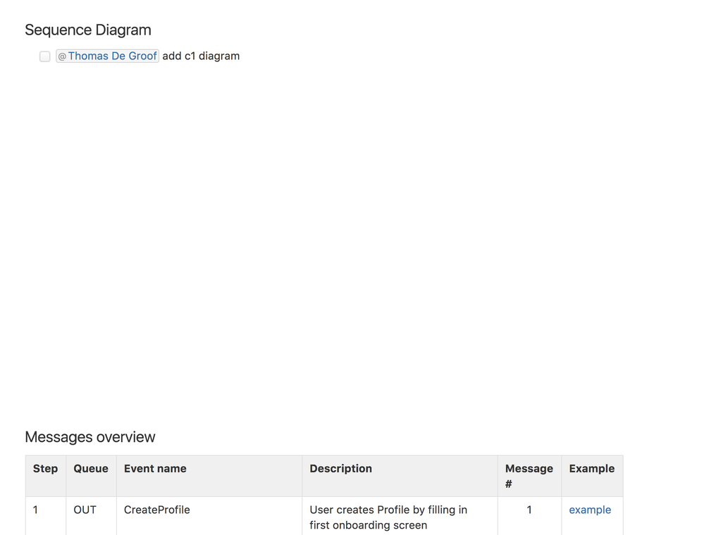

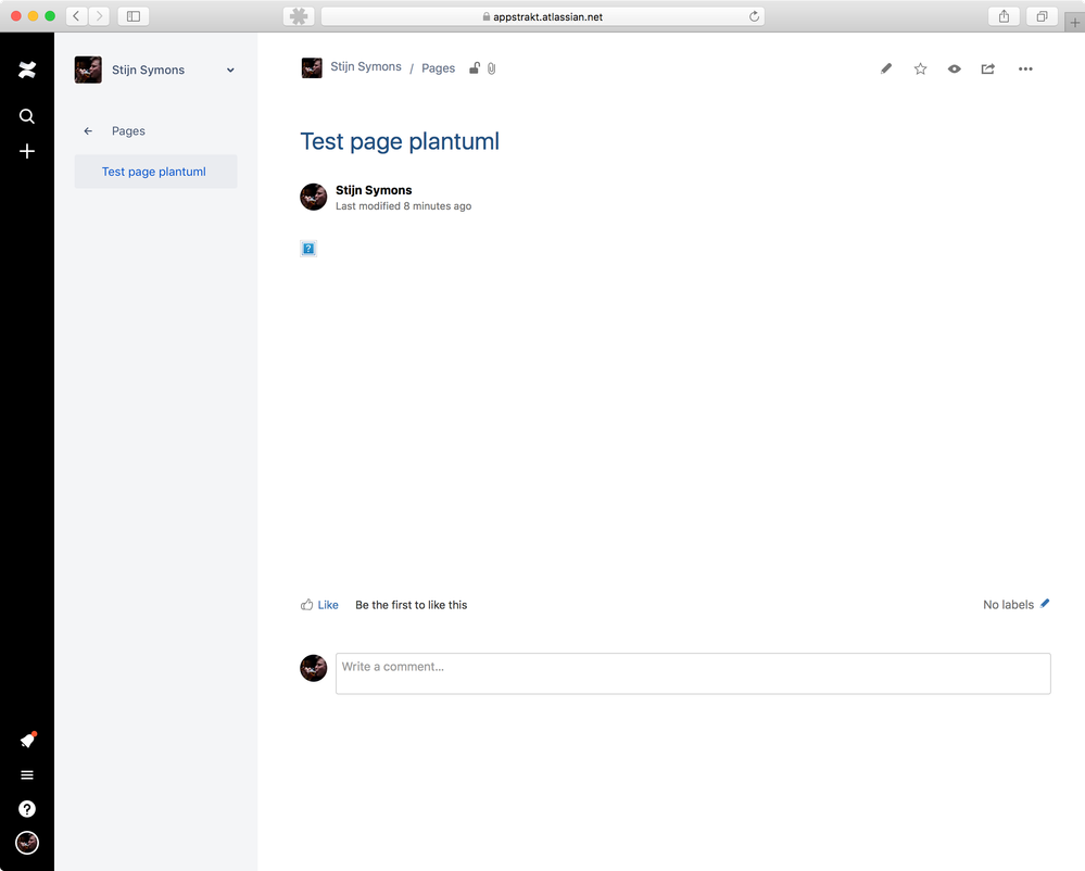

- no image is rendered on the page (neither after publishing) - see screen below

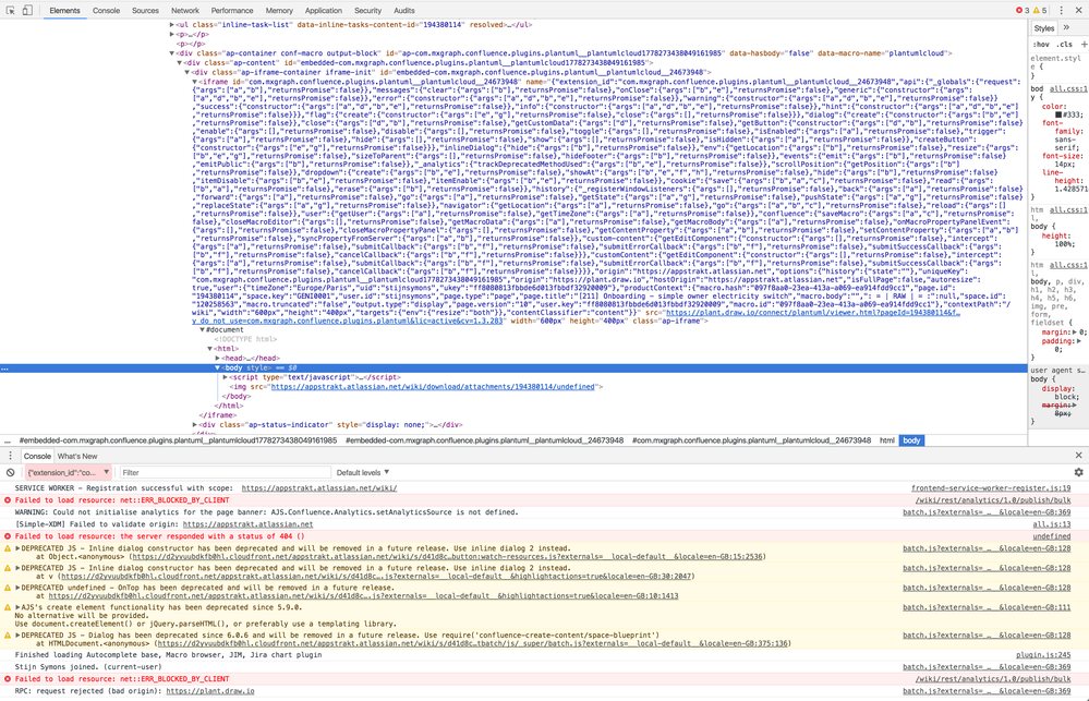

- Devtools has some error messages, iframe ends into an image named "undefined" which does not exist

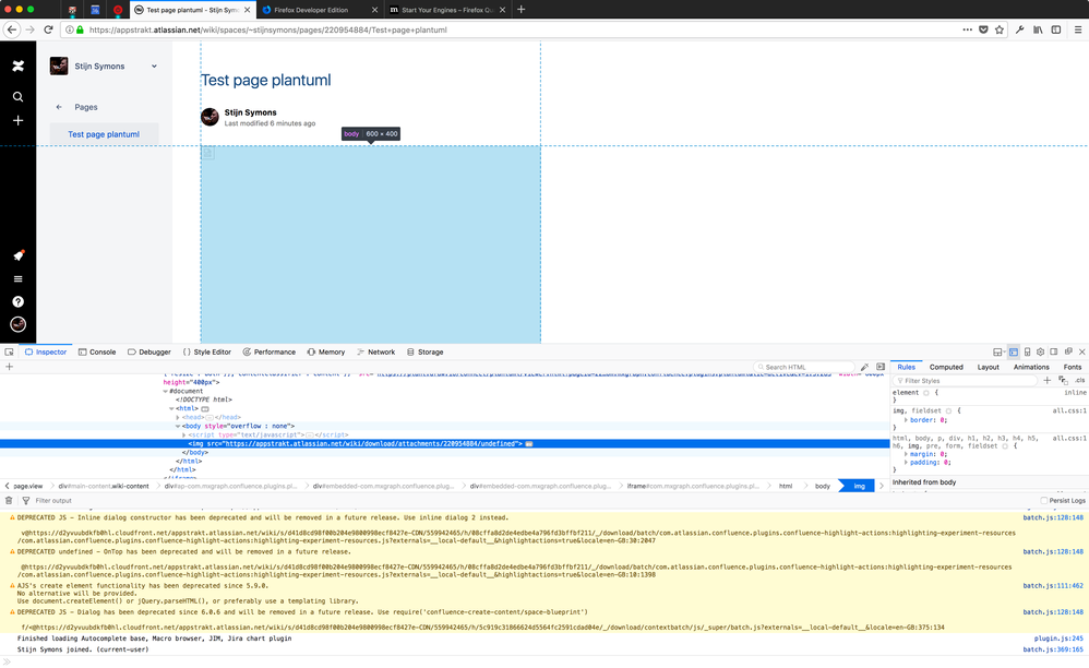

- tested on chrome, firefox and safari on mac - all have the same behaviour, in the end it loads an iframe with a /undefined as image

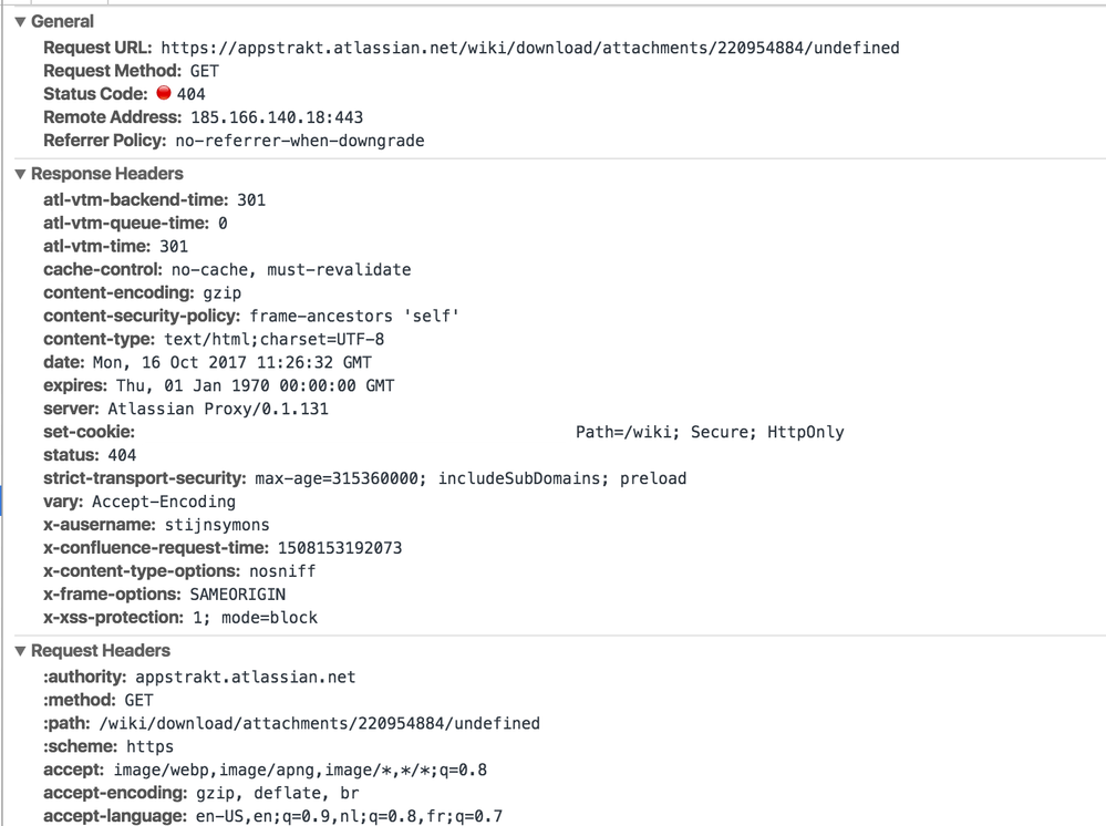

Could you show me, in the network tab, the requests that returned those 404s please?
below the details of the request call to the actual image. (redacted the cookies)
You're hitting the saveMacro bug described at https://ecosystem.atlassian.net/browse/CE-1148. Please vote and complain freely.
