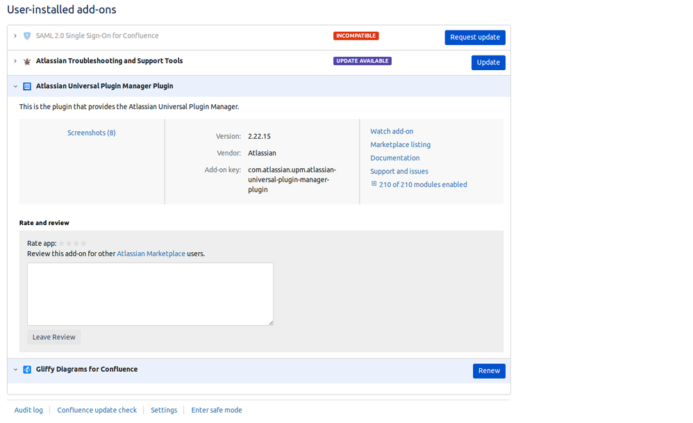

When upgrading Confluence we needed to update some of the Plugins for compatibility. (thanks for the upgrade check, works like a charm)
When I tried this for a specific plugin  I could not see the detail of this plugin when expanding it on the "Manage Addons" page. (See attached screen shot: UPM works, Gliffy Diagramms works not).
While it was no problem updating the plugin by downloading the new version from the Marketplace and uploading it via the "upload add-on" link we do need this detail view as soon as we need to update the license information for this plugin.

Hi @Reinhard Kiesswetter,
I've seen this behaviour before, when you have a plugin without a valid license (the Gliffy one seems to be expired). I assume that's a Bug in UPM.
If you click on Setting at the bottom of the Screen and uncheck the "Connect to the Atlassian Marketplace" & do a reload in your Browser.
That should give you the Details on the Gliffy Plugin ... you can then disable it / update the license, check the version, whatever you like to do.
After that you can reenable the connection to the marketplace.

Reinhard Kiesswetter October 1, 2018
Hi @Christian Reichert _resolution_.
You are a wizard, Christian! Disabling the "Connect to Atlassian Marketplace" really revealed the details of the Gliffy plugin. And you were also right, nobody update the license key on time...
Sad thing, re-enabling the option in the settings show the same behavior as before. Maybe I raise a bug for this with Atlassian.
October 1, 2018
once you apply a valid license, it will be fixed. So once the Gliffy Plugin has an valid/uptodate License again, then the problem will go away even with the marketplace connection turned on again.
Turning it off is just a good means to apply that license.
