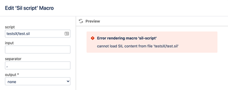

Does anyone use Power Scripts for Confluence? It looks like the answer to a prayer but I installed it and copied a test script but when I add the SIL "macro" and run it, it just says "cannot load SIL content from file". Maybe I haven't configured something correctly but I don't know what.
I GOT IT TO WORK! First, I'm an idiot and my program were in the folders "silprograms/examples" but the program is configured to look in just "silprograms."

If you are getting something like the screenshot below, your subfolder or files' name may be incorrect. Other than that, I don't see any other reason.

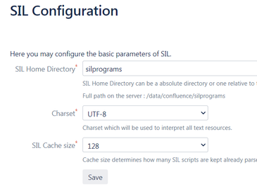

Yes! I'm getting the same error as your attachment. In what way would my subfolder or file names be wrong? I just installed and left defaults. Home directory is "silprograms"... I do have the name of script correct. Any ideas?

I installed Power Scripts and left all the default configurations.

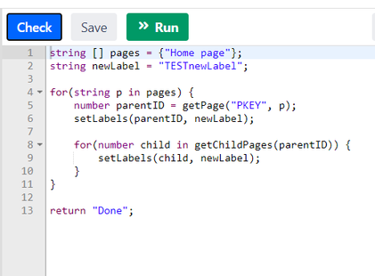

I took your example AddLabelsToChildren and made TestAddLabels. I'm not sure which variables need to be replaced and with what, though. Here is what I have at the moment.
Right now, if I run this from the Manager, it returns the word Done but doesn't add any labels.If I add it to a macro on the Home page, it says "Cannot load SIL content from manager."

What do I put in the first line for "pages = "...the name of the home page? The space and the home page?
Do I need to replace PKey with something and if so, what?
