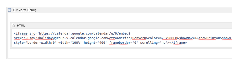

I'm putting the HTML macro with my iframe within my DIV macro.

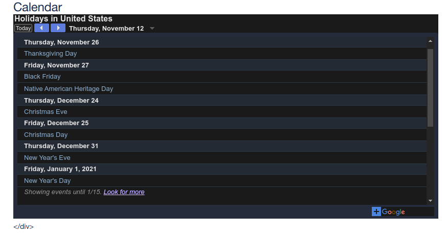

screenshot_2020-11-12_08.32.09_img.pngThis is what the rendered page looks like.  The iframe is correctly inside my div container, but there is an extra "</div>" printed after the iframe

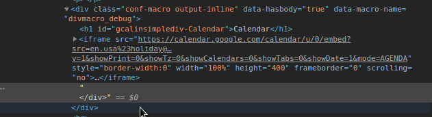

Looking at the page source, the </div> is both in the html as expected but also in some text after the iframe.
This becomes even more of a problem if you have nested div macros or tables, it seems to print out any closing tags after the iframe.

Why are you nesting a HTML macro inside the body of the macro? I would just structure the macro so that all the HTML is inside the user macro, and then you can either have body hold the src link, or even make it a parameter with no macro body. Then use the parameters in your code.
I would also make the width and height parameters to make it more configurable.
If you need the HTML macro, then move that instance to inside the user macro. Take a look at this article I wrote awhile back on wrapping a macro: Getting Started with User Macros - Writing a Wrapper Macro

Putting the iframe directly in the macro (not using the nested html macro):
<div><iframe>...</iframe></div>  still has the issue
Putting just the iframe in the macro seems to work fine.
I will just create an iframe macro and expose some paramters.
