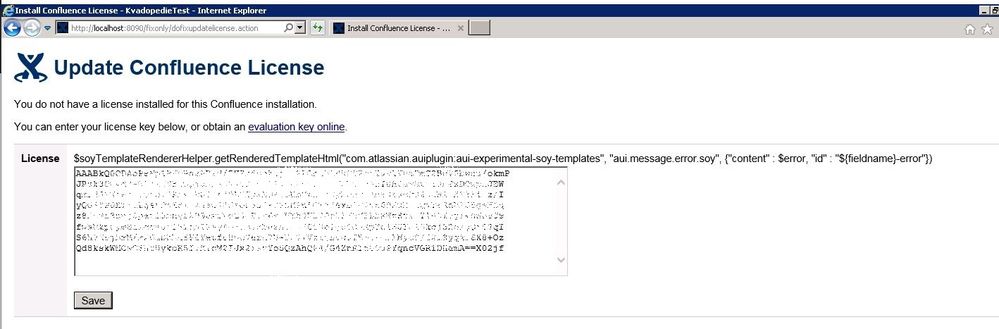

So the upgrade to 5.6.6 followed, but after that - confluence reports an error in the license. "Your current license is not valid for use with Confluence Server"
If I try to insert (the same demo license) again in the dialog http://localhost:8090/fixonly/fixlicense.action
I get an error: $soyTemplateRendererHelper.getRenderedTemplateHtml("com.atlassian.auiplugin:aui-experimental-soy-templates", "aui.message.error.soy", {"content" : $error, "id" : "${fieldname}-error "})
I can't get any further. If I try to deploy version 6 it is missing db objects (tables, columns). If I try to deploy 5.x... (where x > 6) I get a license error. Please what is the next step to get out of this situation? Can you help us?

Hello. It seems that there was one more intermediate step between the older standalone version of the license and the newer datacenter version of the license. For this reason, neither the old nor the new license worked. A new middle license prepared by the atlassian solved the bug.
