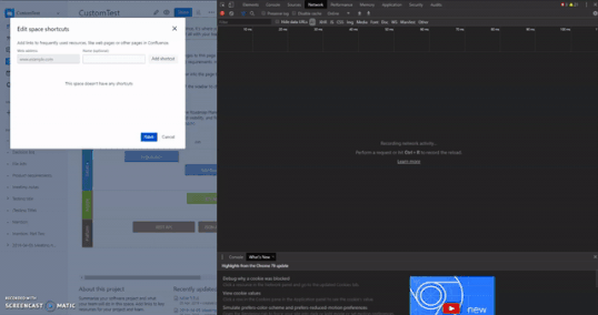

I have been investigating a way to programmatically add to Space Shortcuts (see attached screenshot) as part of our space templating process.  Ideally, it would this would be an available REST API to make this call but I haven't found one that exists.
I reaching out to the community for any ideas for a work-around that would allow for Automation.

Looking at your request, I believe that I can give you some guidance on how to get started with that. The first thing that I wanted to clarify is that we do not have a REST method to work with these shortcuts. We can try to achieve your desired results with JavaScript, for example.
The first thing we want to look into is the network activity that happens when we add the Space Shortcut. Here is a GIF of what I did:
So, what is happening is:
We are looking at the network activity, specifically of the moment that we click Add Shortcut and Save buttons
We need to look into the Batch that shows up right after clicking Add Shortcut and the CGRAPHQL that shows when we click Save.

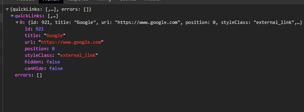

The Batch contains the info that we need to later use in variables in the CGRAPHQL. You will notice that the CGRAPHQL does not contain values, but references. Those are inside the Batch.
Here, screenshots of what you should see inside them:
Batch:
For us to get the values inside those, you can Right-Click > Copy > Copy as fetch. This allows us to work with them in a text editor and JavaScript to apply whatever method we might need.
