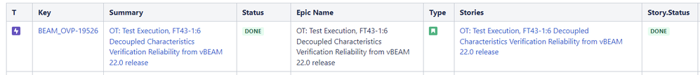

My objective is to use Confluence as a live dashboard for reports, and get away from copy/paste data in to Powerpoint status reports. These reports requires selecting fields from different levels of the hierarchy and presenting them in one common view, e g a table with Epics to the left and their Stories to the right.
For one-to-one relations, Confluence has some great capabilities. Jira Issue/Filter macro combined with Table Transformer macro enables us to create a row that maintains the issue type icons, issue key/summery URIs and status icons. In below picture shows how this formatting is maintained keeping Jira look-and-feel, with directly selectable links.
However, in our data model we have a lot of objects with one-to-many relationships, e g Epic with multiple Stories. Dashboard therefore need to have one Epic to the left and multiple stories to the right (w/ type icon, key URI and status fields) in the same row.

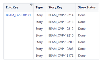

I accomplish this using the Table Transformer macro by grouping on column 'Epic.Key'. But the formatting is lost, leaving me with only text.

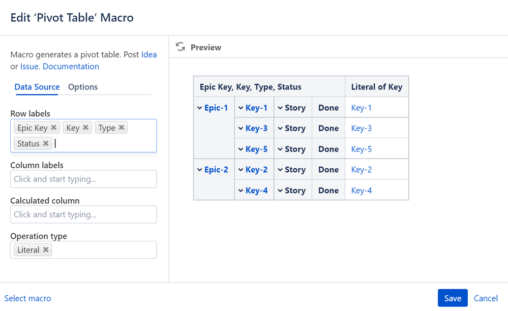

Hi @Jimmy Petersson ,
You may use the Pivot Table macro for this case:
Put the story Key column with unique values as the second one to group your table:

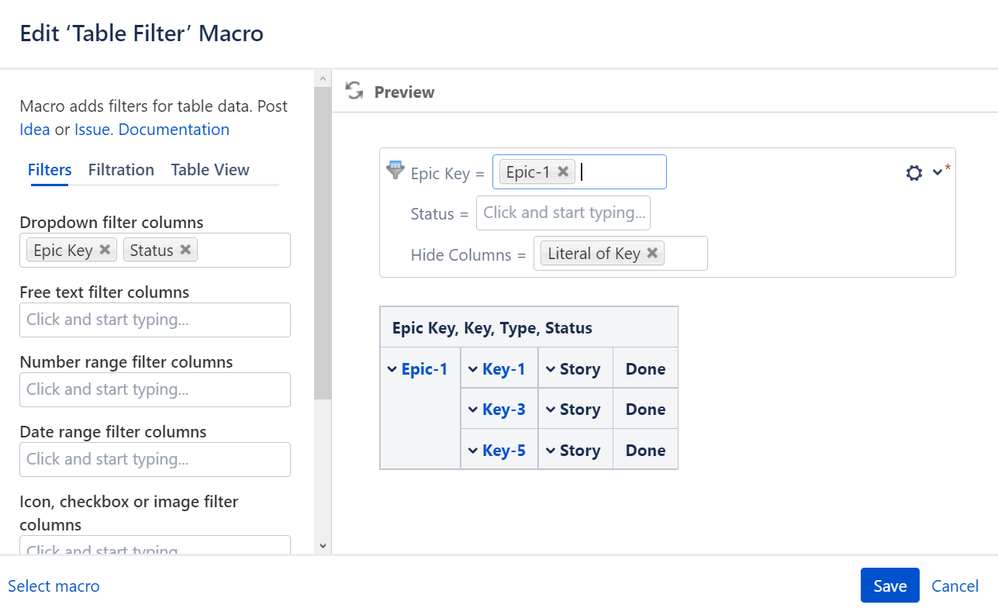

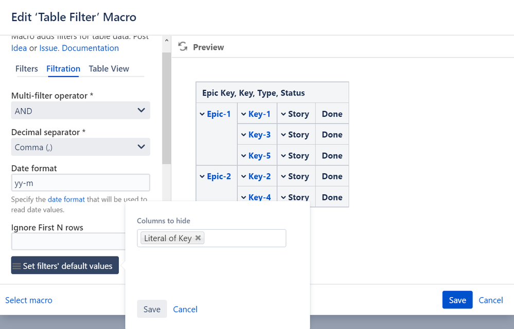

Now go to the Table Filter macro and hide the last column:
The result table can even still be filtered through the Filtration panel view (Filtration tab -> Filters' display mode):

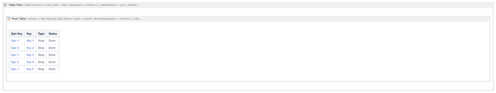

I used your examples and managed to create a pivot table that keeps the formatting!

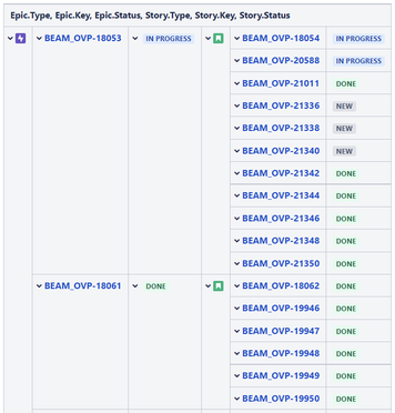

I even managed to make a nested pivot table aggregating all the epics:
So conceptually your solution works perfectly!
