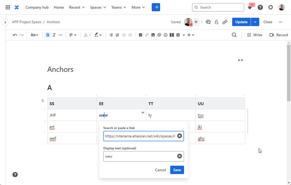

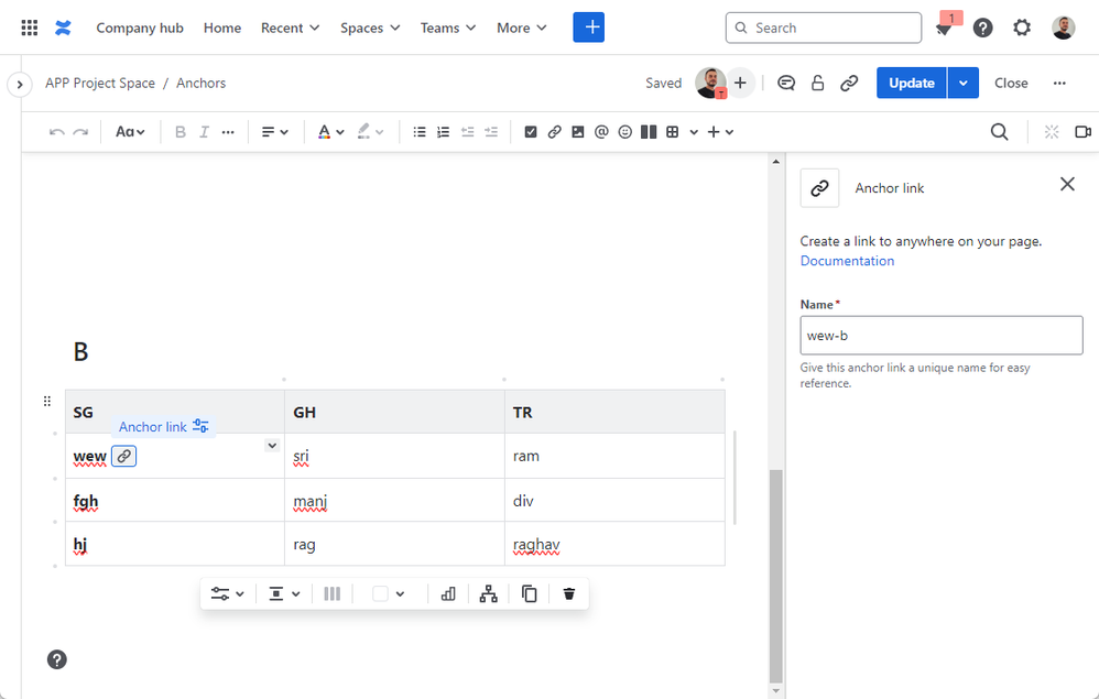

  1. In table B, next to wew I've added Anchor macro and named it "wew-b"2025-01-13 22-33-05.png
  2. In table A, I've added a link to "wew" word with syntax: https://sitename.atlassian.net/wiki/spaces/APP/pages/1901592577#wew-b
Once you publish the page, you should be redirected to the "wew" part in table B once you click on the link on "wew" in table A.
It should work vice versa too.
