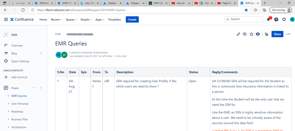

Pl. find below, I wanted to insert Filter Table Macro for the table displayed below. Pl. help with every steps to achieve it.
I am trying to filter a table using default Filter Values for a particular table Column “status”. That is, I want only the rows with the “Open” as value found under the “Status “ column in my table. Pl. support
My using the ID : Venkatesh Vivekanandan [REDACTED EMAIL ADDRESS]

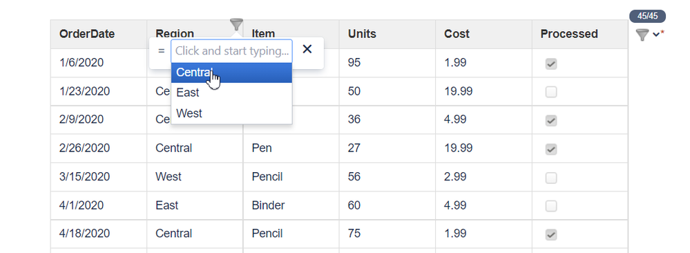

1. Make sure that the Table Filter and Charts for Confluence app is installed in your Confluence instance. There is no app icon in the page view mode on your screenshot. You can ask your Confluence Administrator if the app is available.

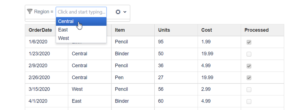

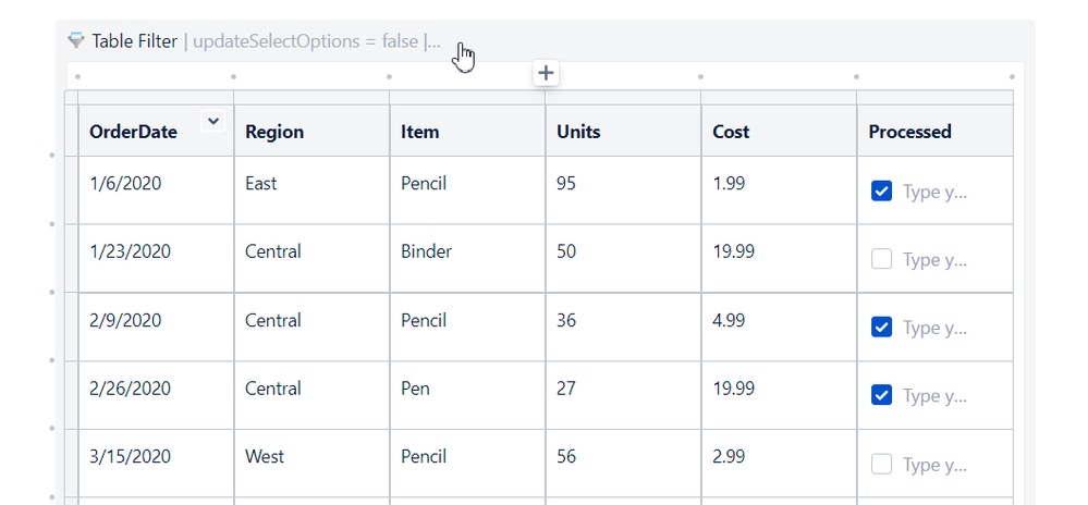

2. Click the filtration icon in the top right corner of your page in the page view mode and enable filtration for your table or insert the macro manually in the page edit mode and place your table inside the macro body.
3. Filter your table data on the go in table headers or with the help of the filtration panel.
