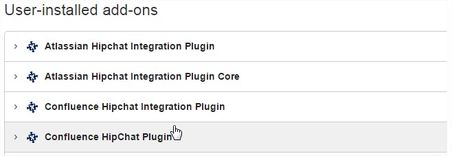

Those are system plugins and you are unable to remove or uninstall those trough the UI. However if you go to the marketplace page of HipChat for Confluence and download the latest version of the plugin those 4 plugins will be displayed as User installed add ons instead of system add ons:
I'm not showing in above image but those are in version 6.29.2
When those plugins are listed in there you will be able to remove/uninstall the add ons without any restrictions, however what is interesting (and confusing at the same time) the previous versions of the plugin (the one that came built in) will not display in the system add ons right away since the confluence cache still have the data of the plugin you previously installed.
