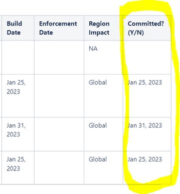

I have a column called 'Build Date'. I created another column called 'Committed (Y/N)'. I want the Committed column to return a value of Yes or No, depending on if there is a build date listed.
What I've tried so far: I thought I could do it by creating a WHEN/THEN/ELSE SQL, but both columns either list the dates in both (like above) or both columns go to YES and NOs. See below
SELECT 'Key',
FORMATWIKI(SUM('Build Date')) AS 'Build Date',
FORMATWIKI(SUM('Enforcement Date')) AS 'Enforcement Date',
FORMATWIKI(SUM('Region Impact')) AS 'Region Impact',
FORMATWIKI(SUM('Build Date')) AS 'Committed? (Y/N)'
FROM (
SELECT *,
CASE
WHEN 'Build Date' IS NULL
THEN "No" IN 'Committed? (Y/N)'
ELSE "Yes"
END
FROM T*)

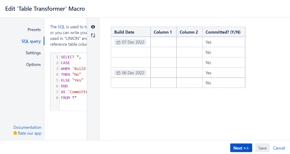

Please modify your CASE WHEN statement as following:
SELECT *,
CASE
THEN "No"
ELSE "Yes"
END
FROM T*
As you can see, everything works as expected.
What concerns the first part of your query:
What are you trying to do with this part of the code, especially with the last entry in bold? It seems that you take your ‘Build Date’ column and show it as 'Committed? (Y/N)'. Thus your “Yes” and “No” from the internal SELECT are overwritten by the dates from the ‘Build Date’ column – the result column has the same name 'Committed? (Y/N)'.
Please check this moment once more.
