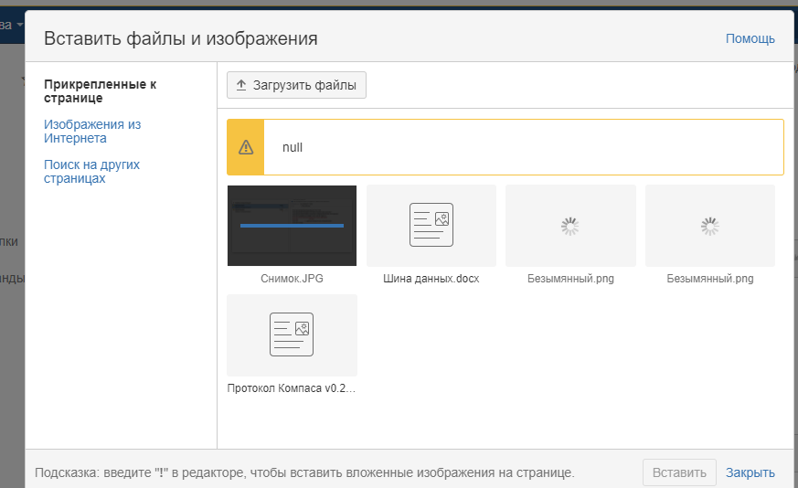

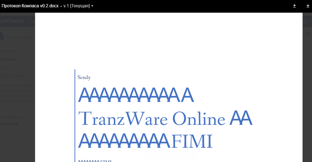

 Russian language in attached documents

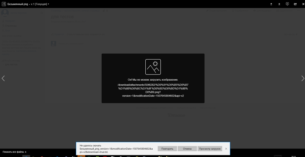

Russian language in names file upload
Confluence was originally installed on a Windows server with built-in DB, there were no such problems. After installing on CentOS and migration of the database, problems with the Russian language appeared. The texts on the pages are displayed correctly

Denis Zinoviev October 19, 2017
бекапим базу
создаем новую https://confluence.atlassian.com/adminjiraserver073/connecting-jira-applications-to-postgresql-861253040.html#ConnectingJIRAtoPostgreSQL-1.CreateandconfigurethePostgreSQLdatabase
только вместо С явно указываем en_US.UTF-8
ресторим базу
