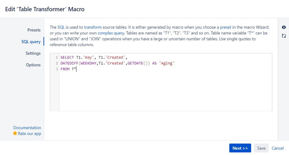

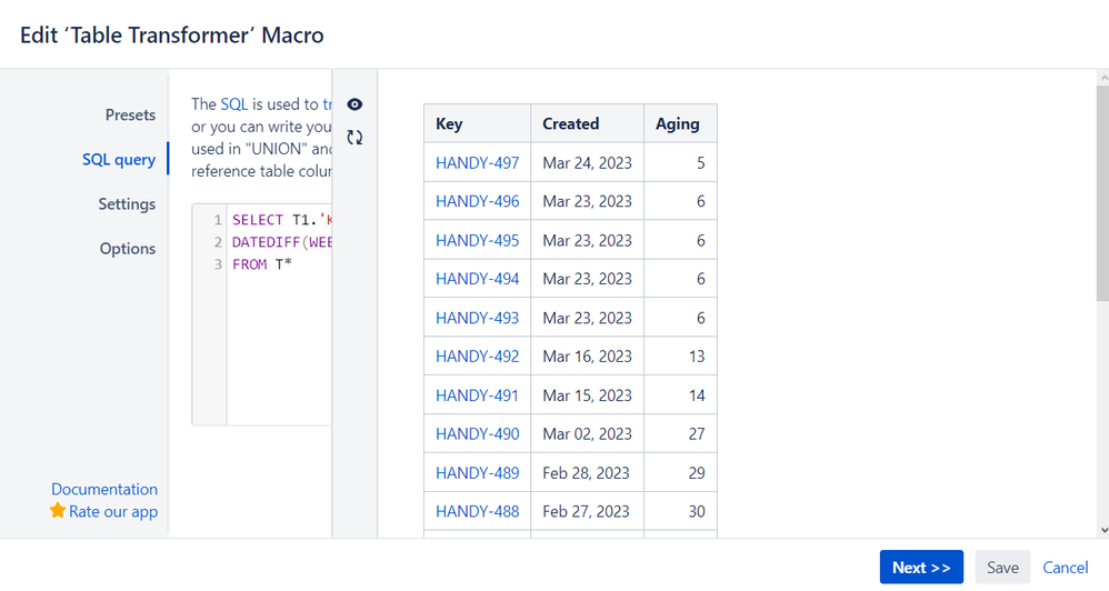

If this is the case, then here are the screenshots from our test Confluence instance:
SELECT T1.'Key', T1.'Created',
DATEDIFF(WEEKDAY,T1.'Created',GETDATE()) AS 'Aging'
FROM T*
So, everything works fine.

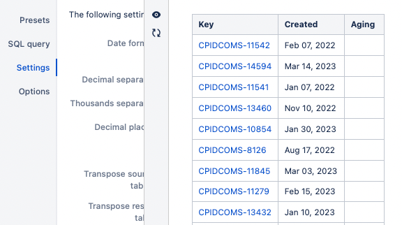

Hi @Katerina Rudkovskaya _Stiltsoft_ ,
This is ask is for Table Transformer and the query is not working for me.
Confluence 7.13.2
