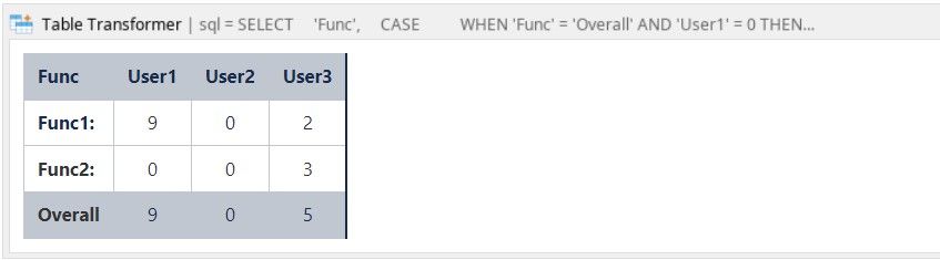

As you can see in below table, there are zero values. I'm trying to use table tranformer to print "" for all 0 values , except for the row "Overall".
My expected result is as below.

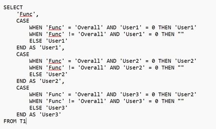

But with the above code pasted, I'm getting my original source table as result. What's wrong? Pls help. @Stiltsoft support

As for now from your screenshot I can see that you use ' ' when you refer to strings.
'Func' = 'Overall'
The first one seems to be the column name, the second one seems to be a string: use " " with strings.
'Func' = "Overall"

That was exactly the issue. Thank you so much.
