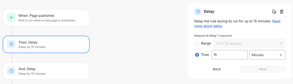

Jira automation has a 'Delay' action that you can use. However, it only allows up to 15 minutes of delay. In your case, I believe if you add four 15 minutes delays, one after the other, you should get the one hour delay you want.
The automation would look something like this:

Hey there @Fieke Neijens ,
@Ana Livia Rocha Silva is 100% correct: we can use the Delay action to postpone the automatic email.
Notice that this feature is only available to Premium and Enterprise Customers, and we can only postpone actions up to 60 minutes per rule:
A delay component can’t have more than 15 minutes or 900 seconds of delay. And the total amount of delay in a rule can’t be more than 60 minutes. This action is available only for Premium and Enterprise plans at the moment.
