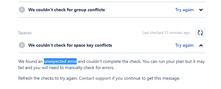

We tested the migration and it worked. Unfortunately we still worked on the server for 2 months. Now i wanted to do an delta migration - which wasnt possible.
So i did a new migration -> spaces already exists.
-> no problem - i deleted the space in the cloud. Just wanted to do it again.
-> created a new migration in the assistant on the server.
-> now i get an unknown error ... :(
any clue to fix this?

First way: if you migrated to a totally new Confluence Cloud instance, that'd, I guess, work. If you can do that, it is the easiest thing probably.
Second way I'd try, is:
  1. migrate to a new temporary Confluence Cloud instance
  2. move the spaces from this temporary instance to your final one: https://support.atlassian.com/confluence-cloud/docs/import-a-confluence-cloud-space/ (maybe there is a tool resolve conflicts, maybe there is no conflict at all, it is worth a try)

Support checked the logfiles and detected an error regarding SSL authentification. After checking our firewall we detected a new blocked connection. fixing this solved the error. migration is now running.
your suggestion would be my fallback plan.
