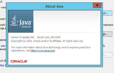

I just installed java 1.8 and still face issues.
I'm not sure what the problem is here. I installed confluence, mysql etc the exact same as production, and it just times out.
