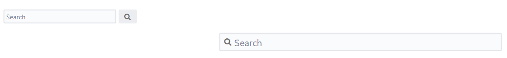

Hi all concerning the LiveSearch Macro
We noticed that the placeholder text is no more displayed since we upgraded from 7.19 to 8.5
Is this a know issue?
Thanks in advance for your help on this.

Jörn Donneau February 6, 2024
Hello, we have the exact same answer, also reproducable in 8.6.2. I raised a support issue with Atlassian.

Pascal Lisot February 6, 2024
Hi @Jörn Donneau
We also warned Atlassian but no answer so far.
There's no trace in the log files whatsoever.
In the mean time we used a temporary (quick and dirty) JavaScript at page level to add the missing placeholder attribute.
Keep me posted if you have some news.

Pascal Lisot February 18, 2024
Hi @Matthias Jupe
Firstly you need to Copy the JavaScript path from the html inspect properties of you input.
You'll get something like this:
#main-content > div > div:nth-child(2) > div > div > div > form > fieldset > div > input
Then you need to add at page level an html macro where you can add your JavaScript to set the missing placeholder attribute.
<script>
// added by lisotpa to bypass placeholder issue in confluence 8.5
document.querySelector("
").setAttribute('placeholder', 'Search by keywords');
</script>
Hope this will help.
Cheers,
Pascal
