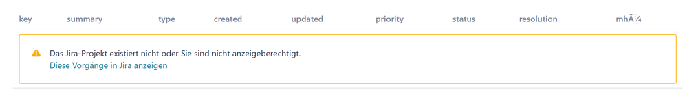

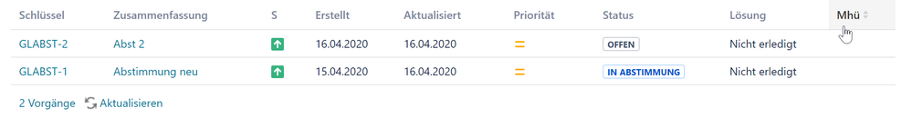

I have the following Jira issue macro in my Confluence page (Server 6.15.8 with Jira 8.2.4 with German as default language) using the custom field "MHü" as a column. The macro uses a Jira filter without "order by":
When sorting the column "MHü" I get the error "Jira project does not exist" and all columns lose their german translation:I can't find an error in the logs. Where could be the problem?
I already run this character coding test without a problem (https://confluence.atlassian.com/doc/troubleshooting-character-encodings-167194.html)

Sorry to hear about this problem. I understand that you have Jira connected to Confluence, but that when trying to show these Jira issues in Confluence with the Jira issue macro, that some accented characters are not displayed correctly, nor are the issues.
In this case, I don't believe the problem actually exists with Confluence's configuration. In my view I think it would be a good idea to check the Jira Server configuration here. Try following the KB Troubleshoot character display issues in Jira server. It's possible that if Jira server is not configured to use UTF8 encoding in the Java JVM, that it could be defaulting to some other character encoding that might be default of that OS (I usually see ANSI for linux, and cp1252 for Windows servers).

Hi Andy,
thank you for your help. The wrong encoding in Jira was the problem. I added the parameters to Jira and Confluence (which also used the wrong encoding) as you suggested.
Thanks a lot!
