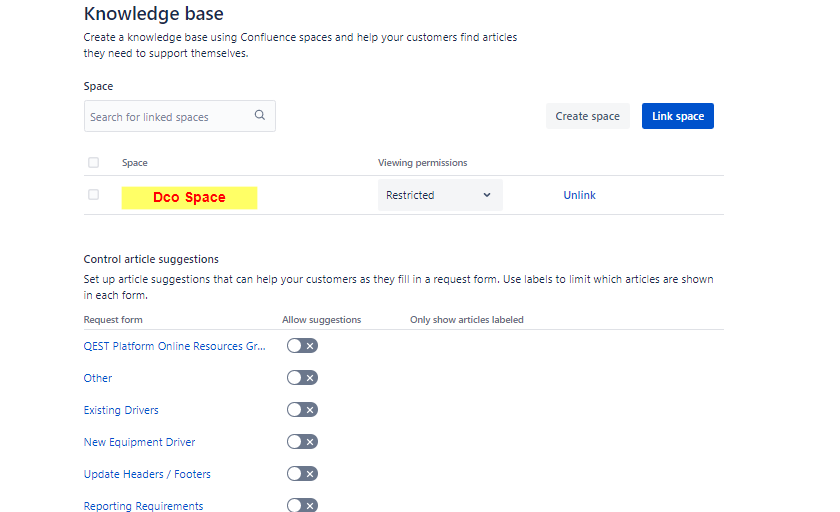

And then we create our Documentation spaces in confluence and allow anonymous access to them so that anybody can check them. But because our customers are usually already logged in so, they are normally not able to access them, and by trial, we came across a workaround which is creating a JSD project for each Documentation space, and in the Project settings and under the knowledge-base section we use to do the below and subsequently all worked good.
But now and since the recent changes to Jira Service Management the view was changed and we are not able anymore to set that thing and accordingly the solution is broken.

KB spaces should not get any anonymous permission till linked first to the Service management project as a restricted access then after that go and set the space anonymous access. This way the KB space will be accessible by both Jira Logged in customers and internet public users.
Restricted means that they just have to be logged into Jira Service Management which they would have had to have been before to search your KB in the application. All service desks will need to be open if you want individuals to be able to search the KB associated with that service desk at the help center level. can you be more specific as to what the issue is you are having?

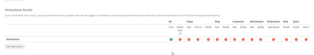

Thanks for your feedback, I actually shared the wrong screenshot, the space in question was shared with the public viewing.
And the issue now is that anonymous access is fine, but having one of our JSD users trying to access the space he gets an error that space has restricted access.

Space permission is set as below:

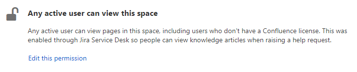

While the Active user part is not showing and in fact this is my real issue, that I'm not sure how to address it as the JSD project does not allow me anymore to turn this on!!
@Mark Elkomos The active user permissions show up when the space is associated with a service desk. Can you confirm that it is associated with a service desk?
Can you unlink and relink the space to see if this updates the permissions.
