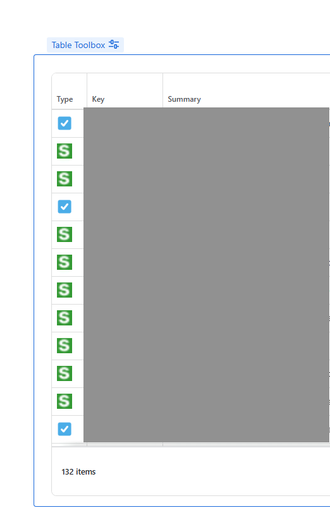

I have created a new blank page in Confluence Cloud. I added a Jira Issues macro to it and configured the macro to reference the Jira Cloud instance. That macro, by itself, returns data correctly from the Jira Cloud instance.
I then add the Table Toolbox macro to the page. I drag the Jira Issue macro into the Table Toolbox macro. Viewing the page in Edit mode the Jira macro still shows issues.

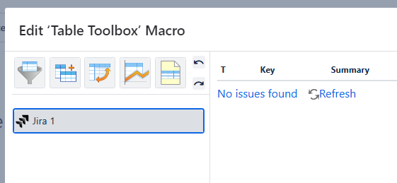

I then edit the Table Toolbox macro. It says "No issues found".
If I hover over the "No issues found" link I see that the Jira URL it shows is the Jira DC URL, not the Jira Cloud URL used by the Jira Issue macro.

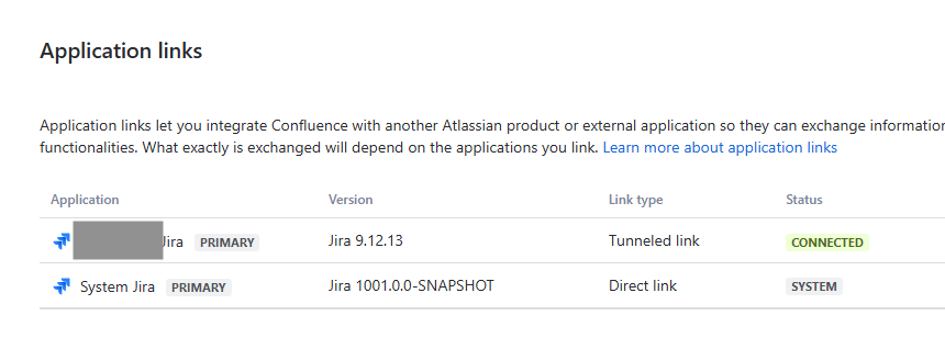

When I look at the Application Links page for Confluence Cloud this is what I see.
The Jira DC link is shown first. I see no way to change which one is listed first.
We are not ready to delete the application link to Jira DC, though I assume if we did that then the problem might be resolved.

I think I found part of the problem.
In my testing I was using the newer Jira Issues macro.
If I instead used the older Jira Legacy macro, then within the Table Toolbox configuration highlighting the Jira element would show that same results as the Jira Legacy macro.
The next question to answer is if it is a known limitation of Table Toolbox that the newer Jira Issues macro is not supported, or is there also a problem related to having multiple Jira application links.

Hi @Trudy Claspill ,
Yes, it's a known limitation due to the lack of support of the new Jira Issues macro regarding the 3rd party macros.
You may read the details here in our documentation: https://docs.stiltsoft.com/tfac/cloud/faq-using-the-app-188612625.html#FAQUsingtheApp-IstheappcompatiblewiththeJiraIssuesmacro?
