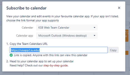

The included screenshot shows the settings I choose when using the subscribe button in confluence:
The https://uisapp2.iu.edu/ is the url that you are directed to input into the CalDAV Synchronizer settings.

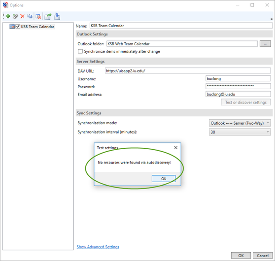

Here is a screenshot of my settings in CalDAV. When I press “Test or discover settings” I should be met with a list of available calendars with this connection info, but instead I get “No resources found”.

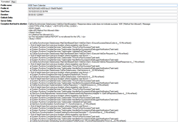

If I go ahead and hit “Ok” and save the profile, an error report is generated. Here’s a screenshot of that and I’ve included a raw text version of that report as well in case you would like it. It is below this screenshot.
<?xml version="1.0" encoding="utf-16"?>
<SynchronizationReport xmlns:xsi="http://www.w3.org/2001/XMLSchema-instance" xmlns:xsd="http://www.w3.org/2001/XMLSchema">
<ProfileName>KSB Team Calendar</ProfileName>
<ProfileId>f407b25f-8d03-4855-bcc3-15fa6676a843</ProfileId>
<StartTime>2018-10-10T17:22:39.5788132Z</StartTime>
<LoadErrors />
<EntitySynchronizationReports />
<ExceptionThatLeadToAbortion>CalDavSynchronizer.DataAccess.WebDavClientException: Response status code does not indicate success: '405' ('Method Not Allowed'). Message:
&lt;!DOCTYPE HTML PUBLIC "-//IETF//DTD HTML 2.0//EN"&gt;
&lt;html&gt;&lt;head&gt;
&lt;title&gt;405 Method Not Allowed&lt;/title&gt;
&lt;/head&gt;&lt;body&gt;
&lt;h1&gt;Method Not Allowed&lt;/h1&gt;
&lt;p&gt;The requested method REPORT is not allowed for the URL /.&lt;/p&gt;
&lt;/body&gt;&lt;/html&gt;
at CalDavSynchronizer.DataAccess.HttpClientBasedClient.WebDavClient.&lt;EnsureSuccessStatusCode&gt;d__10.MoveNext()
--- End of stack trace from previous location where exception was thrown ---
at System.Runtime.CompilerServices.TaskAwaiter.ThrowForNonSuccess(Task task)
at System.Runtime.CompilerServices.TaskAwaiter.HandleNonSuccessAndDebuggerNotification(Task task)
at System.Runtime.CompilerServices.TaskAwaiter.ValidateEnd(Task task)
at CalDavSynchronizer.DataAccess.HttpClientBasedClient.WebDavClient.&lt;ExecuteWebDavRequest&gt;d__9.MoveNext()
at CalDavSynchronizer.DataAccess.HttpClientBasedClient.WebDavClient.&lt;ExecuteWebDavRequestAndReadResponse&gt;d__7.MoveNext()
at CalDavSynchronizer.DataAccess.CalDavDataAccess.&lt;GetVersions&gt;d__20.MoveNext()
at System.Runtime.ExceptionServices.ExceptionDispatchInfo.Throw()
at CalDavSynchronizer.Implementation.CalDavRepository`1.&lt;GetAllVersions&gt;d__9.MoveNext()
at GenSync.EntityRepositories.VersionAwareToStateAwareEntityRepositoryAdapter`4.&lt;GetFullRepositoryState&gt;d__5.MoveNext()
at GenSync.Synchronization.Synchronizer`11.&lt;Synchronize&gt;d__27.MoveNext()
at GenSync.Synchronization.ContextCreatingSynchronizerDecorator`7.&lt;Synchronize&gt;d__3.MoveNext()
at CalDavSynchronizer.Scheduling.SynchronizationProfileRunner.&lt;RunAndRescheduleNoThrow&gt;d__22.MoveNext()</ExceptionThatLeadToAbortion>
<ConsiderExceptionThatLeadToAbortionAsWarning>false</ConsiderExceptionThatLeadToAbortionAsWarning>
<Duration>00:00:00.1229901</Duration>
</SynchronizationReport>
