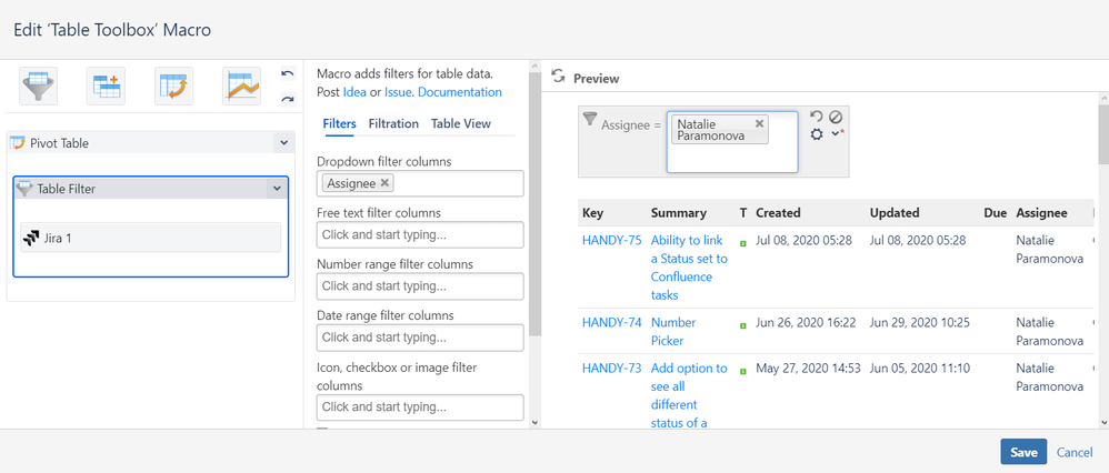

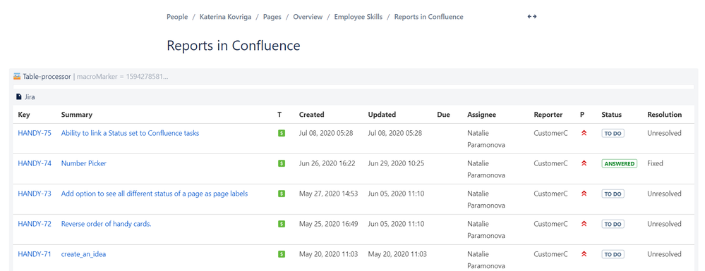

For the Cloud Confluence instances use the Table Toolbox macro to nest several macros. You won't be able to do it manually because of the Cloud editor limitations.

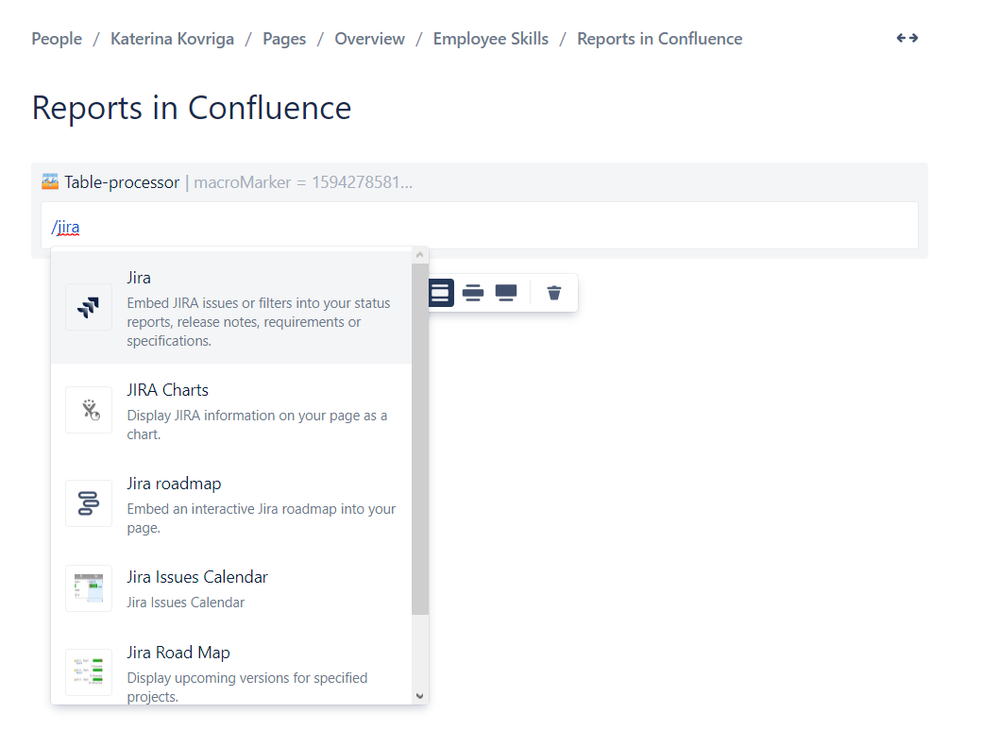

Insert the Table Toolbox macro on your page and then insert the Jira Issues macro right into its body.
You'll got smth like this:

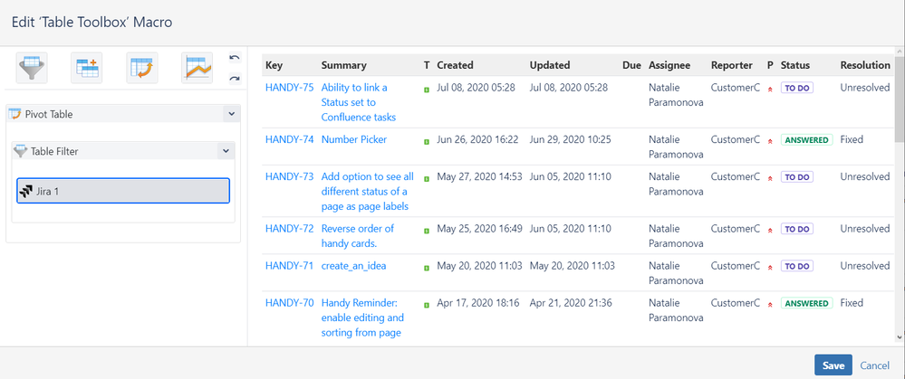

Now go to the Table Toolbox settings - there you'll see your Jira Issues macro. Drag and drop the icons on the left and wrap your Jira Issues macro into one or several macros of our app (it depends on your use case).
Then go to the macro settings (for example, the Table Filter macro as is shown in the picture below) and implement your case.
