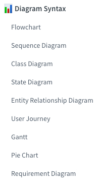

Could you confirm if all the diagram types enabled by Mermaid (see attached image) are supported by the draw.io Confluence integration?
Thank you!
Hi Alok. The Mermaid syntax is supported by draw.io for Confluence Cloud. So if the syntax that you created is correct, it will generate a Mermaid diagram inside of draw.io. To insert Mermaid syntax, please go Arrange > Insert > Advanced > Mermaid.

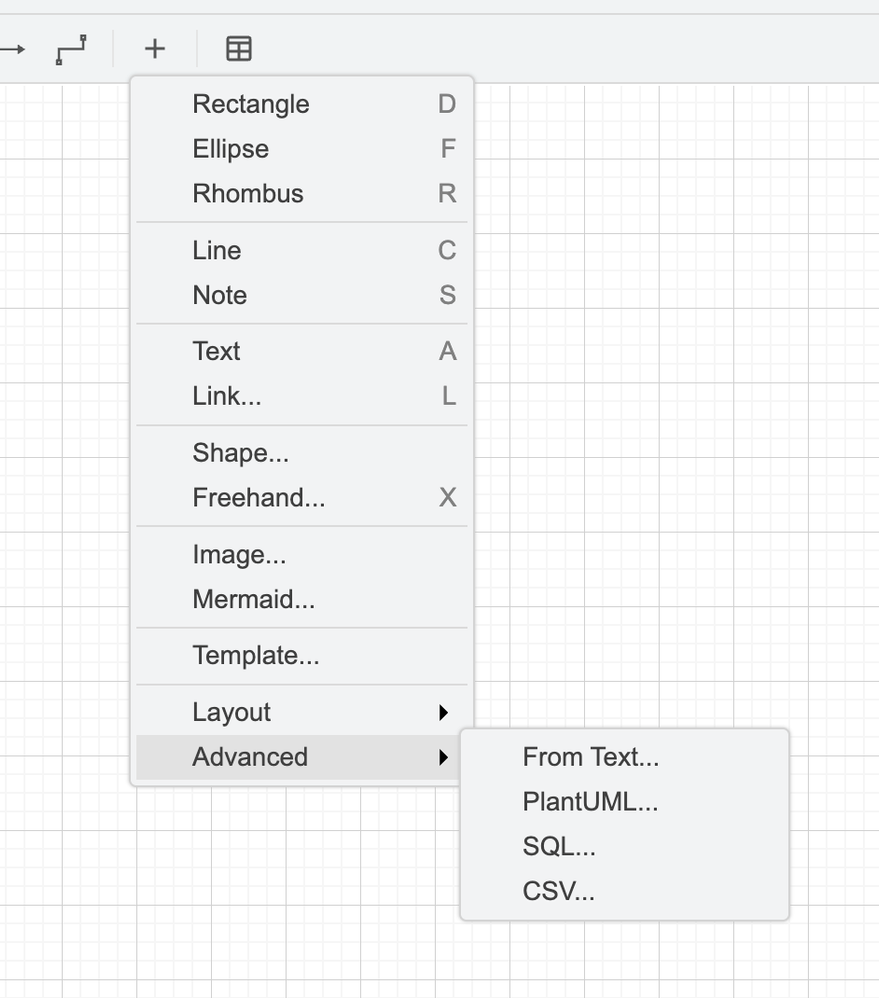

I know this is an old thread, hopefully anyone can help me.
I'm using draw.io inside Confluence, but did not see the Mermaid option at all under the Advanced menu.
Please refer to the screenshot below.
What does it take to have the Mermaid option? I'm on the free version of Confluence.
Any hints would be appreciated, I've been googling for days without clear answer.
Thank you so much.
-- Ken
I was looking for the same thing under Advanced based on advice from a while back - but it has moved, apparently, to the same level as Advanced - so look at your menu diagram above Advanced and you'll see "Mermaid...". I tried that and it works to import mermaid code to create an ERD.
