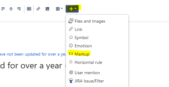

At least I understand the syntax better than I did before. A follow up question if I may? That the CQL syntax is suported in a 'markup' construct on a page, e.g. just pasting the query in the 'insert markup' macro. See attached for where I mean.

Hi James,
I can certainly try to help. I've never inserted CQL in Markup before; what are you trying to accomplish here exactly? Are you inserting a particular macro?

Hello Shannon, again thanks for your time.
What I am trying to is I think quite crude but effective.
Before we moved to our current hosted version of Confluence from our self-hosted older version (I don't know the numbers) the home page of this space I am interested in had what looked like a single one line query, created using markup, which confluence seems to turn into a 'macro' (as if it had been added as a search macro).
The query in this markup simply listed all pages in the same space that had not been modified for over a year - this allowed us to always be able to see which pages might need an update (or even deleted) because of their age without having to make a manual search using these often esoteric query language params.
Since the upgrade however this 'markup-cum-macro' now reports
Error rendering macro 'search' : Invalid date period: -365d.
So whatever the syntax was 'then' is not valid now.
Unfortuately it seems I cannot see what the original markup was as it gets converted to a macro 'as if' I had instered a 'search' macro directly from the built-in ones available to us.
Even though I can edit this macro directly, I cannot seem to create a query that does what I want - list only those pages that have been un-edited/last-updted for over a year.
I thought therefore I could try to just insert a new markup with a query and be done.
It has turned out a bit more complicated than I thought.
Sorry if this is something really obvious but I am just a general user with some access to edit pages and was trying to fix this myself.
I hope this makes more sense.
