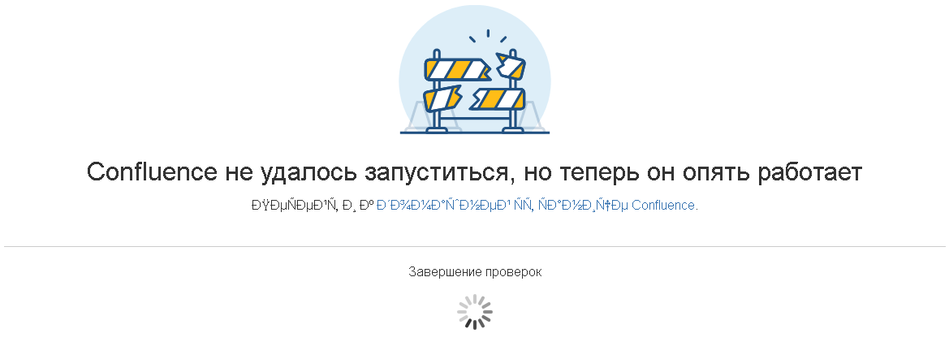

The confluence server (v6.5.1) was deploy on the test environment then I migrated data from our productive confluence (v.5.9.11) to test.
 After starting confluence on test, I see next trouble «Confluence failed to start, but now it works again» (on screen).
Our prod Confluence work excellent.

Hi Maxim,
I understand you imported a site backup from your Confluence 5.9.11 production instance to a newly installed test instance of Confluence 6.5.1. Please let me know the current state of your test instance. Is it accessible and serving pages as expected?
None of the errors you posted look like show stoppers, so I am curious what the symptoms are that we need to work on.
